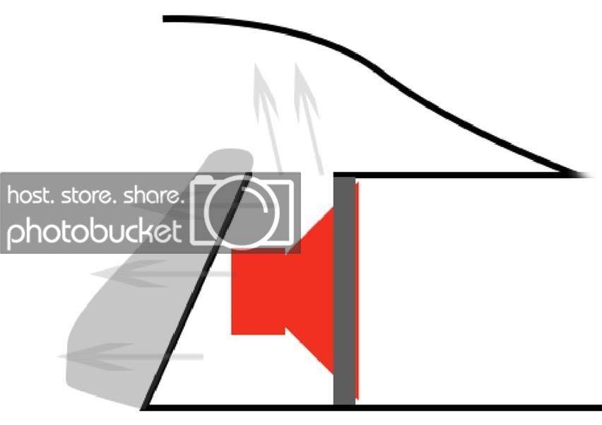

I've spoken to a reputable industry veteran, whom suggested to create a baffle that is positioned 6” back from the rear seat and have it open up through the rear deck so the bass can pass through the rear seat and up through the rear deck. Based on this statement, I sketched up the following. The rear deck already has two 6x10" openings directly above the drivers, which vent into the cabin. No cutting the rear deck. No welding...and far less expensive.
Maximizing my cargo space isn't my top priority, although it would be nice to gain more than I've had in the past. Even with this design, it takes up less space than my pair of sealed IDQ 12s; and far less space than if I built a spec sealed box to house a pair of IDMAX 15s.
I kind of wanted the motors to be exposed for a different aesthetic than I've had in all of my past systems, but with this design, that would eat up a lot more cargo space than I'm willing to give up...just to see the magnets when the trunk is open. Oh well. Not a deal breaker. I think it should sound good.
Fingers crossed for my first IB setup and my first pair of 15s. Although I'm not an SPL guy, I can't help but to worry if I will have enough output to satisfy my needs...with only 500w per driver (JL 1000/1). Front stage is a pair of XS69 with 450w (JL 450/4)...excited about these too!
