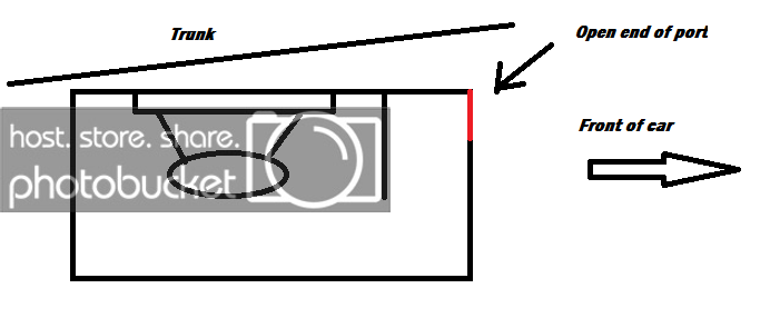

Long time no see. I am helping my buddy install a 15 inch Jugg in his Monte. It has just been brought up, I haven't gotten any measurements or anything but I was seeing if anyone has messed around with the body style. From what it looks I am going to have to put the sub up which is giving me problems w port options. There is a hump in the bottom of the trunk so I need the port to be on the upper end of the box as well.
I am familiar with everything accept for box specs. I understand freq's and cubic feet but when it comes to how long/deep/spotting of ports, I need help. Would I be able to point the sub up and have the port face the back seat on the top side of the box? Excuse my ignorance, its been awhile, and even back then box building wasn't my cup of tea. Thanks
This is something like I am talking about, would it be stable/efficient?

Sub back port back has always been best for daily in all my trunk installs. Sub back port to the side works for some too. From what I have seen you want to avoid sub up in trunks if possible. It can work, but its not ideal in most applications.

Thanks for the tip this is what I was looking for. I have zero experience when it comes to cars and its something I am trying to get the jist of before we tackle it. Wish I would of had all of the info in the original post for you guys but this is the first place I came. Looks like I will be able to barely get it to fit with sub back. About how far off the back of the trunk do you think I need to have the box?
Any tips to reduce rattle? Back seats will be down, deadener will be used, anything extra? Thanks!
Some people also fire sub and port into the cabin and seal it off from the trunk. No experience with this myself and doubt you have the space to do so with the 15. I've always had good luck with sub and port back with the box as far back in the trunk as possible. Best thing to do is scoot the enclosure around until you get the sound that's wanted before securing it down. Deaden the trunk as much as possibl to reduce rattles.
