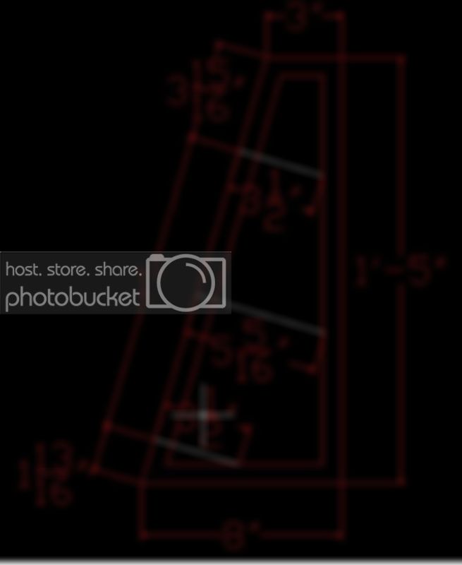

Okay i just got my dads 05 4dr Sierra and want to put in two tens.... The room for the box is about 10" tall x 5" depth1 x 7" depth2 x 56" wide.. Its about 2 cu. ft. before displacement. I wanted to know is this deep enough for either the re 10" that is 5" deep or the ID 10" that is 5.5" deep. It will be sealed and I am not sure which subs to get. Iam looking for more of an sq setup but want it to be able to be loud. I dont have the amp yet either but i am looking to spend no more than $250 for subs and $150 for amp.. Thanks in advance.

As best I can tell when you did your calculations you did not take into account the wood thickness. Those numbers give me 2 ft^3 but when you figure them with 3/4" MDF you only get 1.1 ft^3 and a mounting depth of 5-3/8"
Bump out the dimensions to at least 11.5" High with depth1 of 9" and depth2 of 6-3/8" and 57.5" wide This will give you 1.99 ft^3 with a mounting depth of 7"
