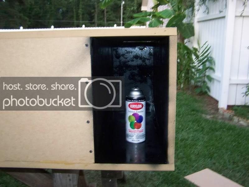

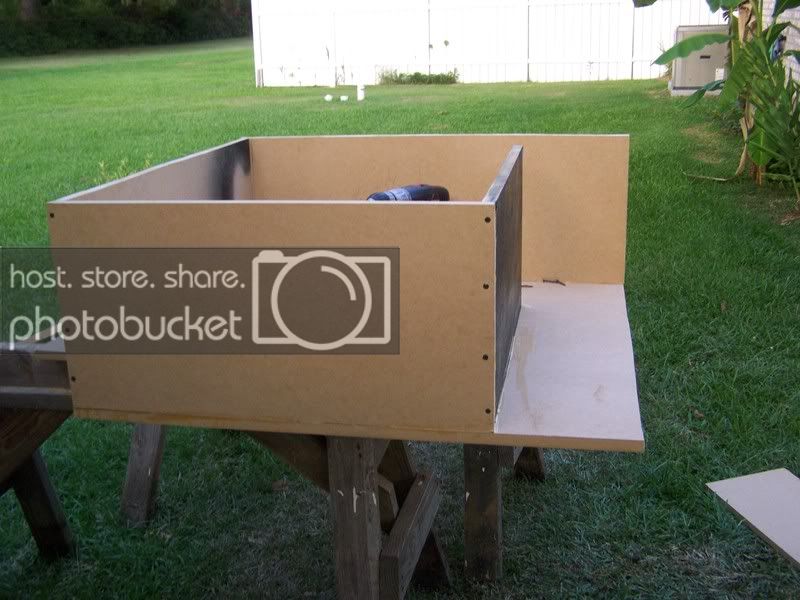

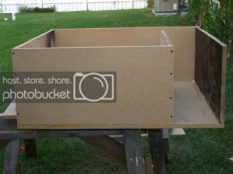

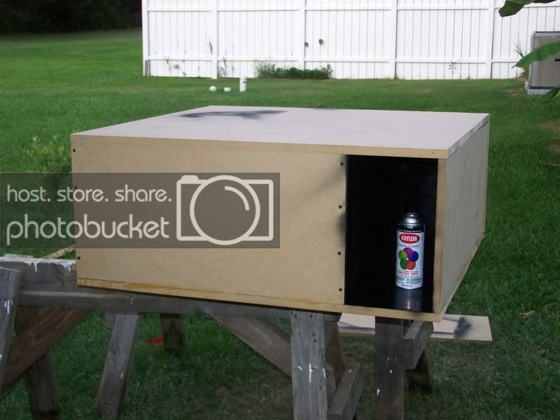

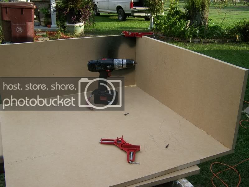

The box for the BTL is 6 cubes tuned to 32 hz with 102 sq in of port.
Now on to the building of the box.
Got Port?

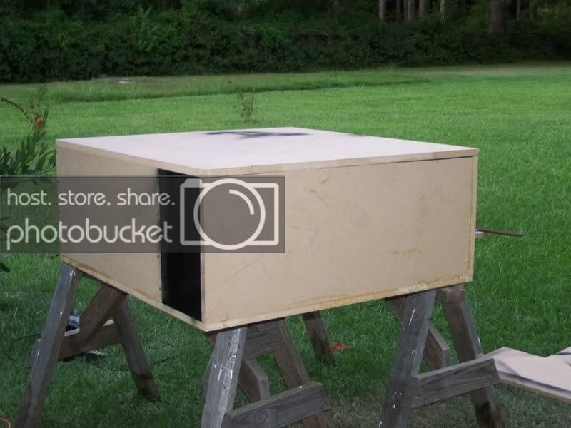

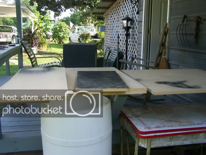

Box will be double baffled, I just laid one of the baffles on their for a test fit.
As for finishes, I think I am going to cover it in bed liner and call it a day. Check back later for more updates as I get more stuff in.

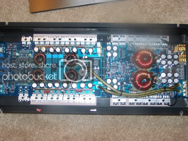

Here are a couple picks of the equipment I'll be putting in it thus far.
TeamPSI's btl he was selling:

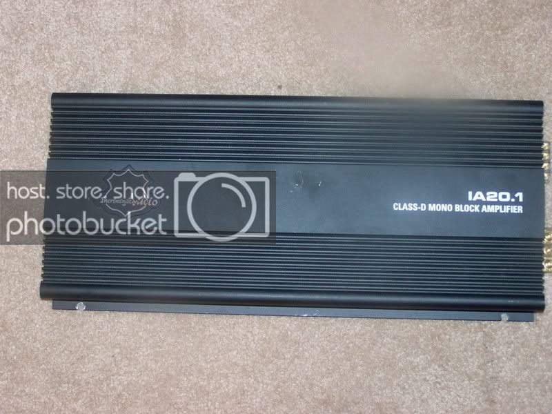

And my 20.1:
Disregard the smudge on my camera lens, I didn't notice it was there when I took the pics, and don't feel like taking new ones.
