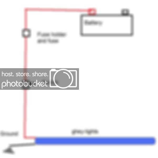

This.
If you still want to wire it up so you can have them come on when you open the door....and you want control over when they do this (like a dome override) all you will need extra is a Bosch SPDT Relay and a DPDT switch. (on-off-on switch)
