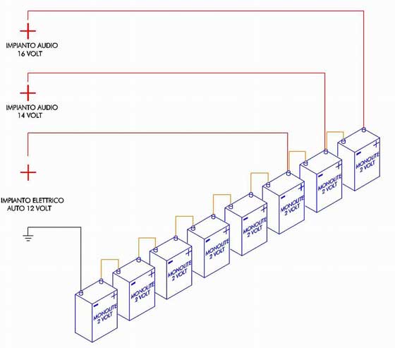

here are a link. - click the battery section, look down at the wiring diagram
http://www.zacksprotos.it/
what the heck.
I hope this pic works

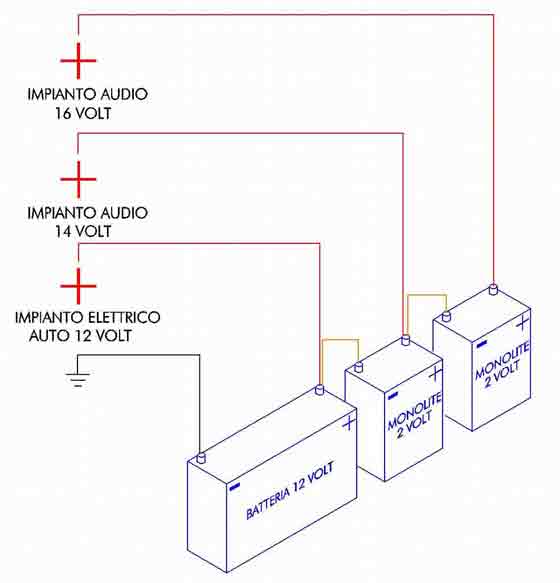

showing the skematic of wiring up a 12v battery and a 2v battery
to give the car a 14v or 16v system.
man I laughed.
wonder if it works tho ?
2 volt batterys. ... weird.
yes I have no interweb skillz.
click the link - go to batterys - click dang battery
then scroll down to the wiring diagram they have.
crack smokinest thing ive seen yet.
wiring a bunch of 2 volt batterys up to 16 volts.
why ?
it is such that you can run your amps @ 16v and allow them to produce more power

I was just curious I guess about those 2 volt batterys.
seems a bit weird.
maby I should get one to keep steady 14v in the system.
or - maby those batterys are good for 20 min then dead cause they so darn small.
yes that works. problem with that is most smaller volt cells have smaller capacity than the 12v batteries so they run out of charge faster and the life span is less usually. i thought about doing it in my van to run a 14v setup.
This is how golf carts run their batteries. Six 6 Volt batteries in series for 36 Volts, when installing an amp you go to the second positive terminal and you will have 12 volts!
As far as those 2 volts go, they wont have the same capacity as your regular 12 V will; using one of those is better than I CAP i would assume though...
even 16v might kill shit.
if you don't know for a FACT what you're running is 16v, it's 12v //content.invisioncic.com/y282845/emoticons/fyi.gif.9f1f679348da7204ce960cfc74bca8e0.gif
