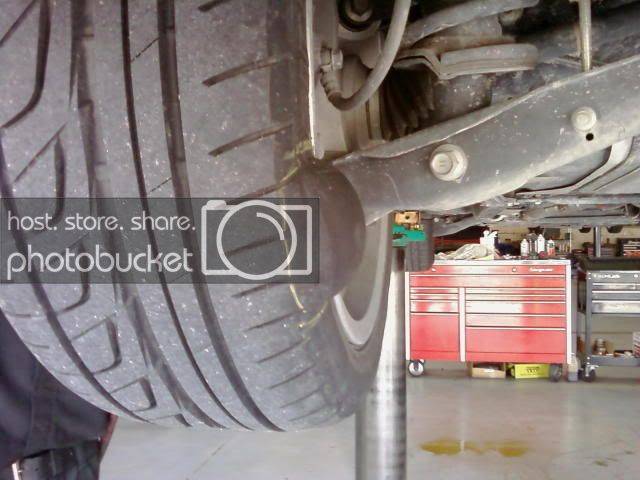

And it comes back with this a week later....
People need to learn to drive!!lol
That is one of the biggest bubbles in a tire that I have seen....
What causes that?
The inner layer of the side wall cracking and letting air psi in between the layers.
This usually happens from hitting a curb or hole or something like that. Thou, there are usually other signs of hitting something. Usually there would be some kind of marks on the rim, the other side wall and sometimes on the tread it self.
They (customer) came in complaining about a vibration but would not admit to hitting anything. There was a mark on the inside edge of the rim so I know they hit something.

A bubble like that is from the steel belts separating. Its most common on the sidewall like seen above, because the sidewall has fewer layers of belts. Usually these bubbles are from trauma impact, but Ive seen tires bad from the factory that do this without any incident to cause it. If its only been on the car a week, I would consider it possible the tire was simply defective.
Ive seen a larger bubble than that, on the tread of the tire not the sidewall, and my brother drove it like that for 3-4 miles. lol
