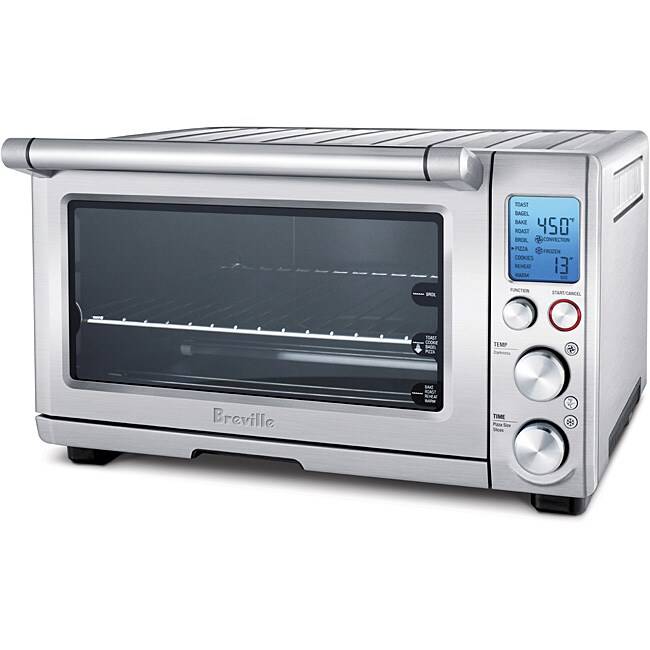

and i'm not talking about the bad *** toaster oven in the back.
