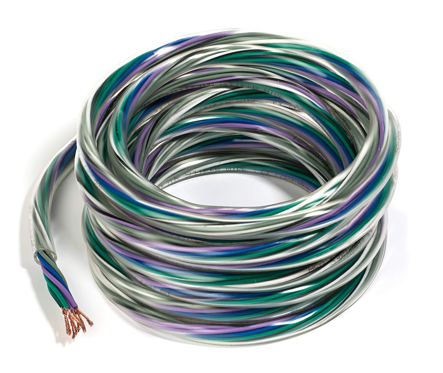

with Speedwire, using the connections behind the dash is the fastest method. wiring to the individual speakers is tedious work - worth it if you replace the speakers since you'll be tearing into the doors anyway. some modern cars have molex plugs at the door jamb so adding new wiring is a PITA.
pros of wiring dedicated to each speaker
- maximum circuit integrity
- minimum circuit resistance
cons
- assload of work
pros of intercepting factory wiring in dash
- easy
cons
- maximum wire resistance
- multiple connection failure points
speedwire has 9 conductors - the Metra standard colors for 4 speakers plus remote.
