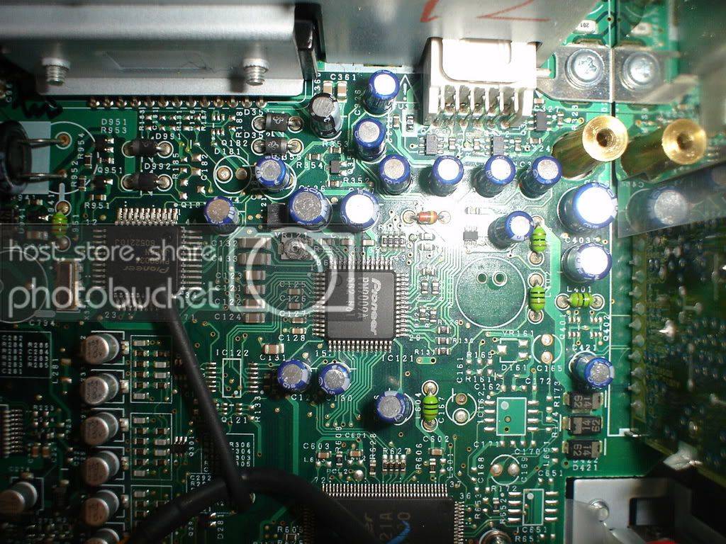

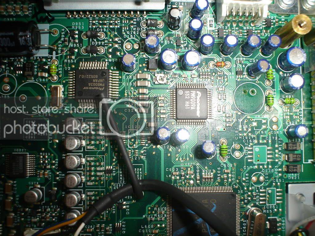

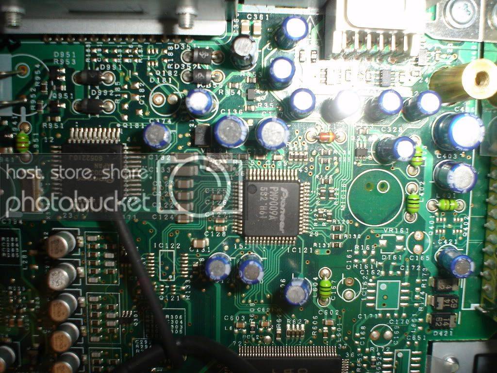

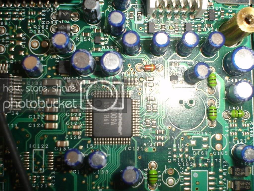

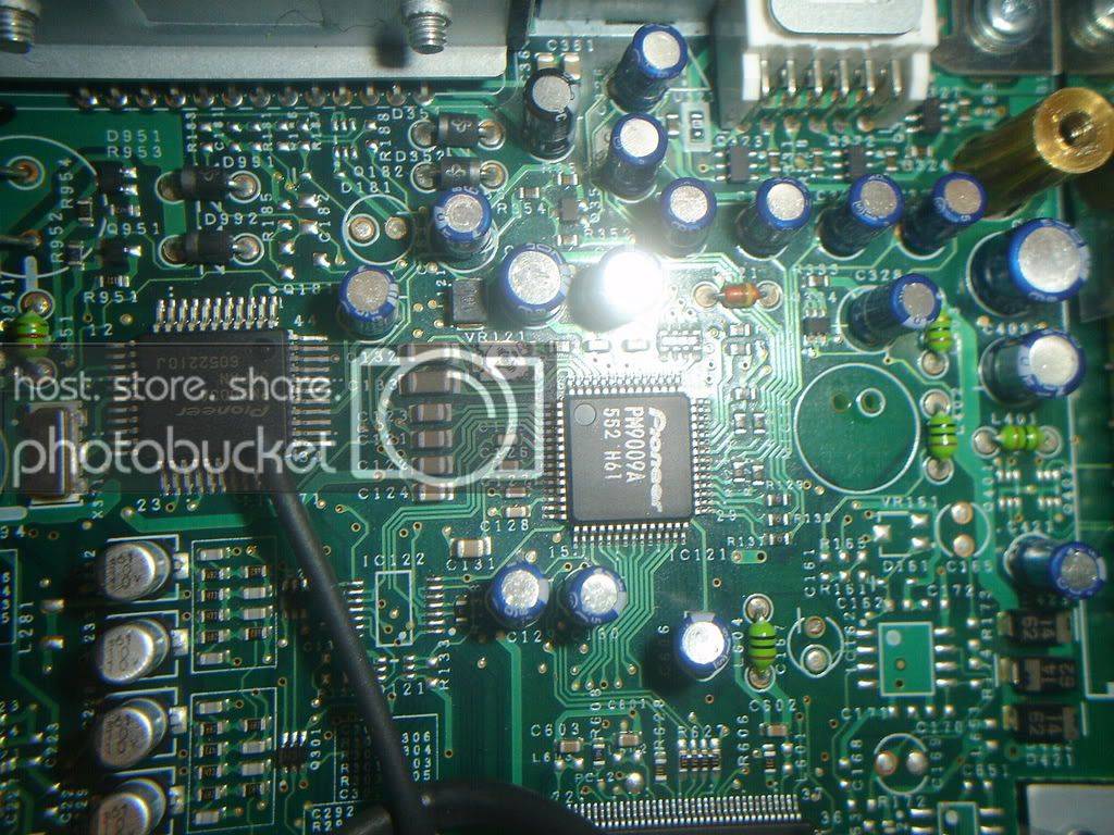

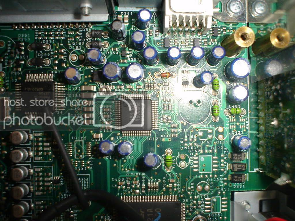

Hey guys I need to repair my pioneer DEH-7800MP. I did the ground loop but I still have noise. I know that the problem is the pico fuse. I live in Dominican Republic so we don't have any Pioneer dealer or Pioneer repair service center. I can't send to the United Stated because it's a loooot of money. So the idea is that people can shared pictures(it will help), comments, ideas, etc..
Any reputable car audio shop who does repairs should be able to take care of it. I had a local shop fix mine. Cost 30 bucks. After they fix it make sure you do not connect/disconnect the RCA's with the power on. I learned the hard way.
ok.. I take some pictures to my radio and I can't find the pico fuse.. I was reading other threats about the pico fuse on the 880 and it calls FU351, I found in the pioneer 7800 the FU321.. I don't know if it's the same but I want someone to confirm. THanks
Picturess:
ok....just to the left of your main harness in, there is an exclamation point. just below that there is what looks like fu321, and then a small unit outlined with white....that is the fuse
