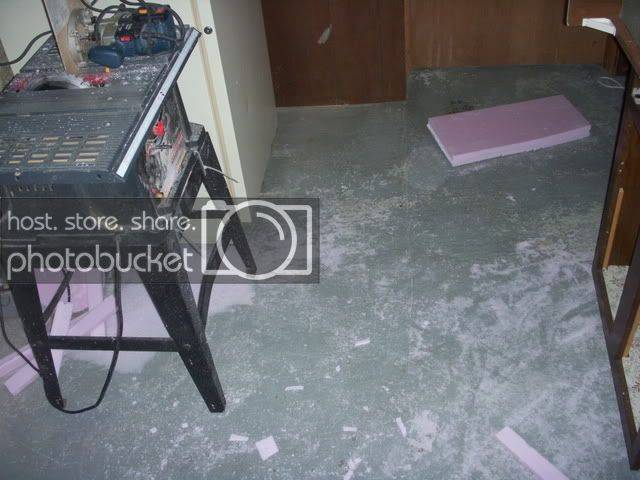

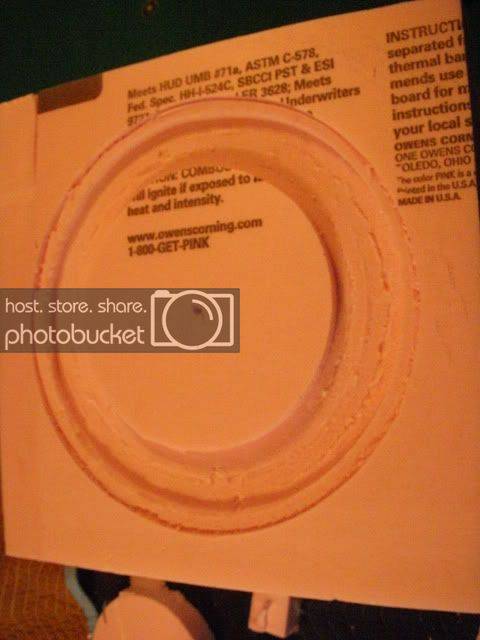

Another useful matieral for shipping items with a lot of 90 degree angles is insulating foam you can find at lowes. This comes by the sheet and is around 8 dollars for a 2x8' peice of foam
i usually go by the rule 1" of foam for every 15 lbs but this is by no means perfect. remember your package should withstand a 4' drop.

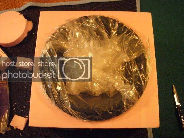

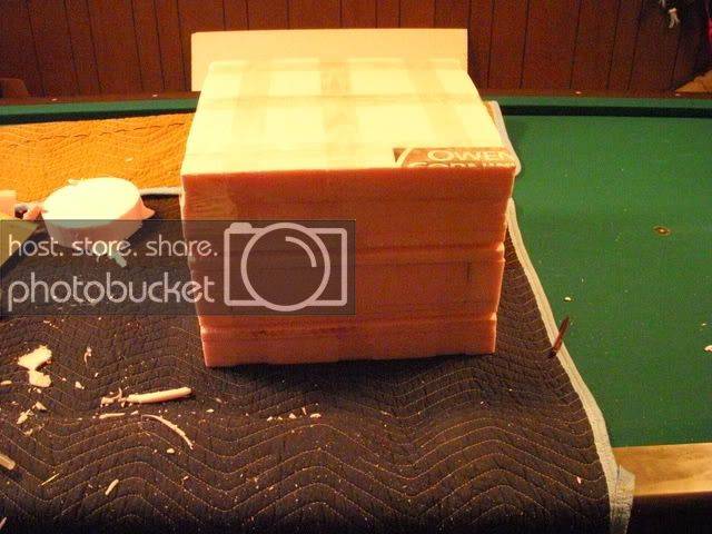

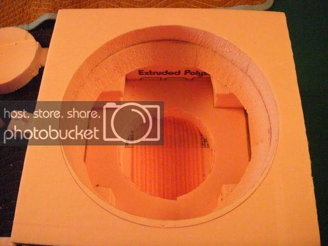

here is the kinetik 2400 getting the foam treatment
2" on each side on the inner box
then for the outer box i used about 2 inchs of packing peanuts all the way around with cardboard spacers in there to keep the box from moving around
