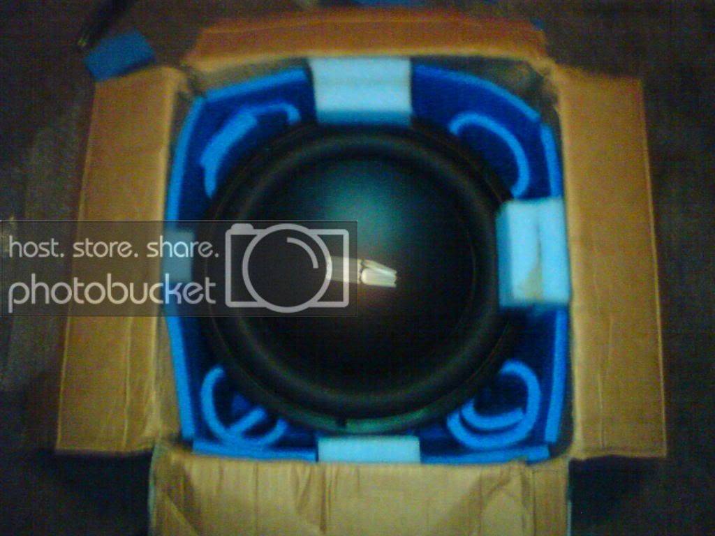

Pics (double boxed in first pic, inner box completely enclosed in foam + additional foam from original packing):

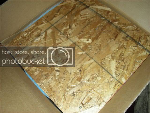

Some of my packing.. Any tips.. I think this sub was a dc lv4 15" being packed up
I would suggest maybe taking a thin sheet of handy board or particle board, very cheap, and cut it the same dimension as the inside of the box like i did mine here:
even made handles out of an old extension chord to pull this heavy bish out! lol package weighed in at 80lbs btw //content.invisioncic.com/y282845/emoticons/wow.gif.23d729408e9177caa2a0ed6a2ba6588e.gif

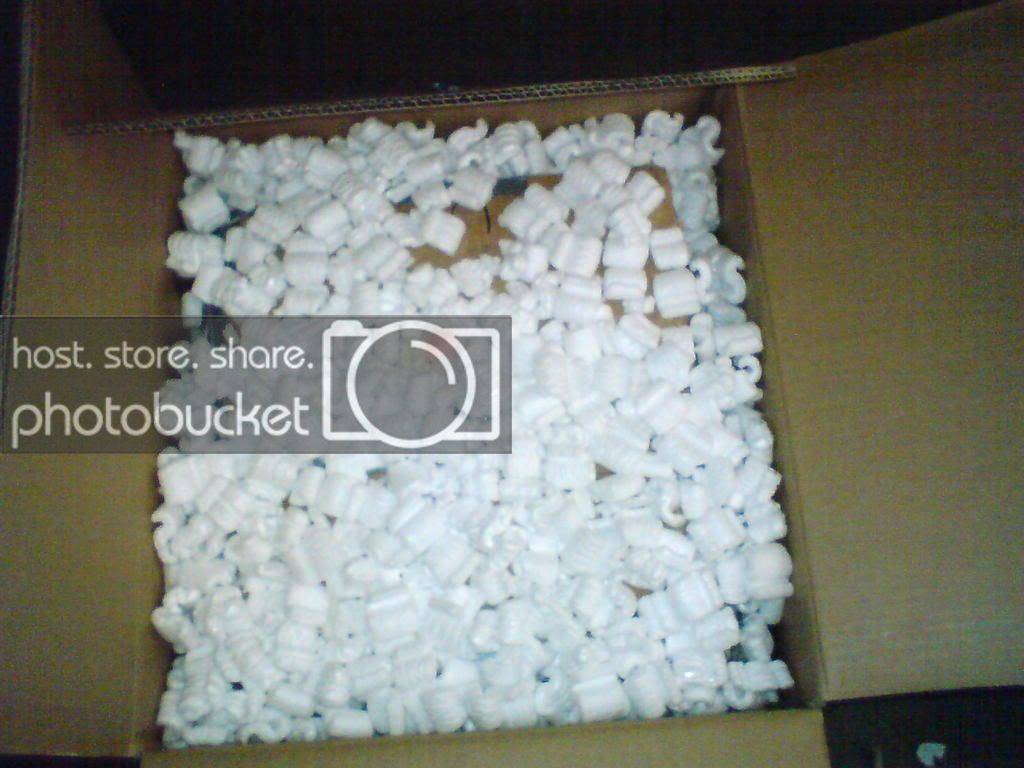

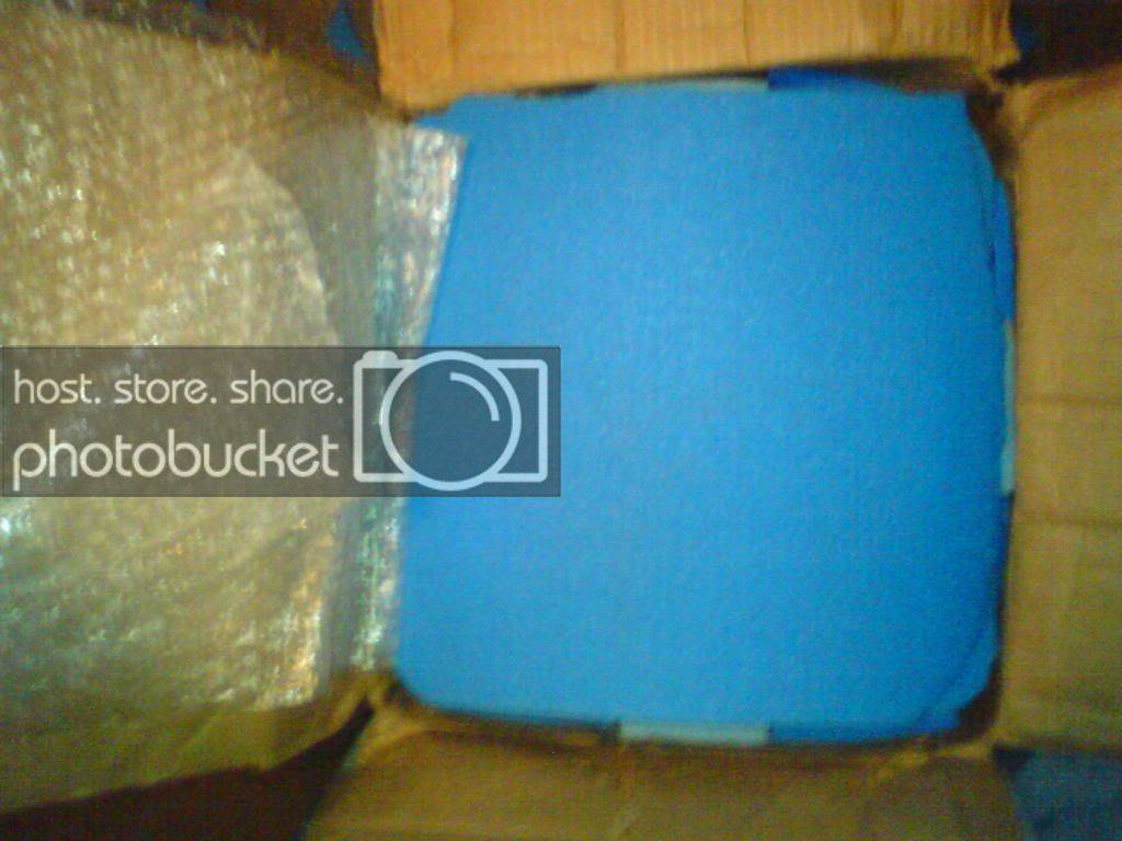

added more packing stuff before closing it up but forgot to take a pic...
and double boxed (home depot boxes~0.96cents a piece I think)
