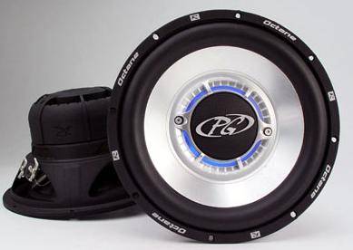

^^ this I once had some phoenix gold octane subs with neon in the dust cap had negative and positive leads coming of the neon I hooked them into the speaker wire and BOOM the more u turned it up the brighter the lights hit
