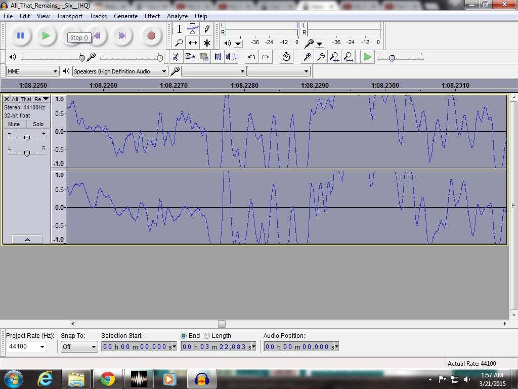

Someone posted something of nature before but i never really got an answer i was looking for. I understand that you need to first deamplify it below 0DB but then you still have clipping/flat wave forms.
I know its really important to find clean sources but ALOT of EDM music today comes with clipped signals fresh from itunes.
How do i get my clipping to be a smooth waveform again or maybe im wording this wrong but i think you understand my gist.
Any help is appreciated.
Care to explain what each does or rather the difference between the two.
As far as i can see, even after normalize/amplifying it. I can zoom in and still see clipped waveforms.

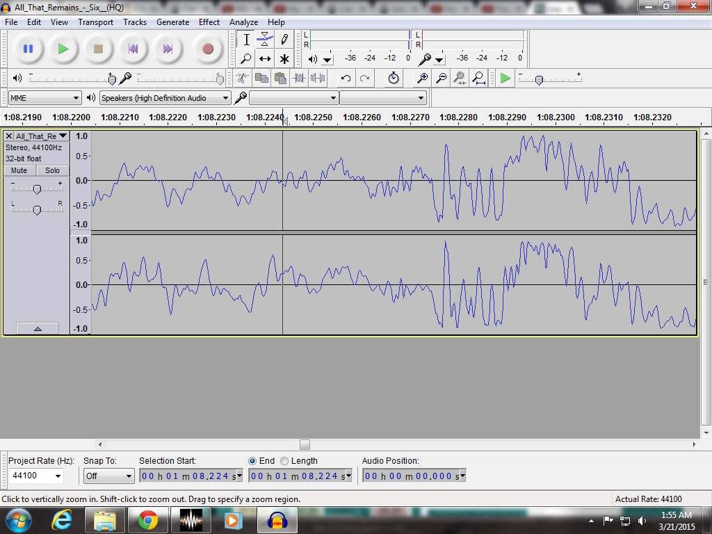

no you are not, clipped forms are anything that passes the line. If you use the normalize feature, you already remedied it and then afterwards amplify it and wave forms will be fine. Hold control and move your mouse wheel to zoom in, they are normal sine waves

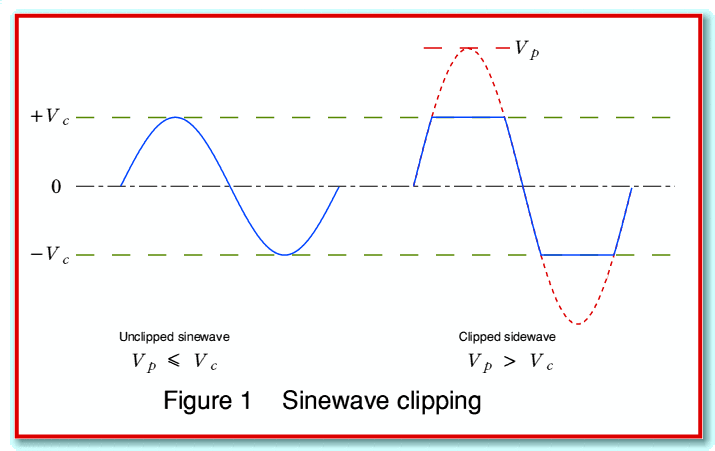

What clipped sine waves look like
What audacity looks like after normalize then amplify its not going past the limiting lines therefore its not clipped thats how sound waves in music look like.
If the music in the source file itself is clipped already you cannot "un-clip" it using audacity. i.e. if the music was poorly mastered or ripped.
