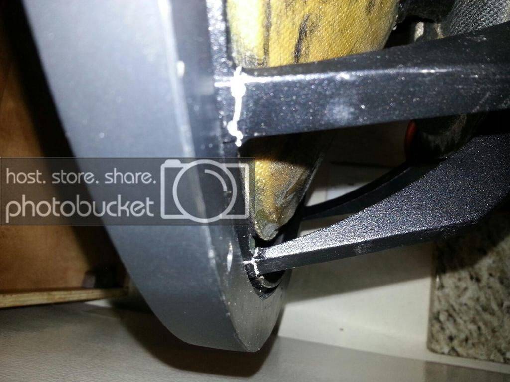

How to fix a cracked basket?

The only person that would recone these is Murphy. DD will not touch them with the Fi motors. It would also cost $500 plus shipping to get it done. That's what I paid last time, and waited two or three months.
jb weld will make them stronger than new
Thank you, that's what I was wondering

Why I asked yeah and sorry to here that. That really *****. But jb weld does wonders
Ya..you can use jb on that..Just be sure to mash it in the crack and not just on the surface alone..It will stop it from continuing towards a break..can be filed down smooth as well..Whatever you do..if you do buy JB..dont get the Quick its crap compared to the original two step.You may even try some Gorilla Apoxy..Thats some bad azz chit
Pic
ive used jb weld to save my *** many times, but idk if id trust it on a frame of that caliber..
personally id take it to a local welding shop, and have them run a bead. An experienced welder will know how low to set the amps to not induce "warpage" from excessive heat. and to not run a solid bead at once etc..
as long as its not aluminum, i think youll be ok
