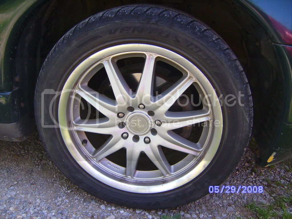

how the hell do i get these rims off
Hydrastas
lol, the owner didn't have any special nuts in the trunk area. im about to just pound these *****es off so i can work on my ******.
You can get a nut cracker... no but really its a special socket that will sort of cut into the nut on the rim, and then you can unscrew the nut. (thats how people steal rims these days..) Also remember to have a new set ready, because doing this will ruin your old nuts. The only way to not ruin them, is to get the correct key. Some larger rims shops usually will have a few spare keys laying around, maybe you will get lucky and they will have a match. Most likely they wont, but once i forgot my key socket, and they had one really close that barely worked. GOOD LUCK WITH YOUR NUTS... KEEP EM NICE AND CLEAN.... and MOST IMPORTANTLY SHINY, CAUSE GIRLS DON'T LIKE RUSTY NUTS.
I worked for some time in a car repair shop and learned a lil trick for those security nuts. You need a socket wich is a lil smaller than the normal size, grab a hammer and hit it all the way until its pretty into it then with a big ratchet take it off.
rim job or ebay tool. if the grooves look evenly spaced you just need a Tuner lug nut wrench or socket...
if they look keyed differently with a unique pattern.. WELD a bolt to the end and unscrew..
I know I have seen a socket type thing that has a bunch of pins in it so it only pushes in the ones needed so it can grip the nut. Kinda like the things kids have where you put your hand under it and it pushes the pins up to look like your hand... If you know what I mean....
