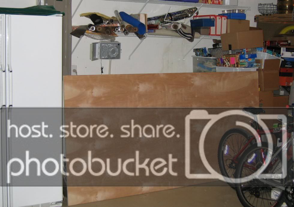

Here's what I got yesterday:
A 4x8ft (I think) sheet of birch ply, $45 from Home Depot. It barely fit in the Odyssey.

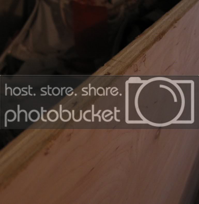

It's quite thick:

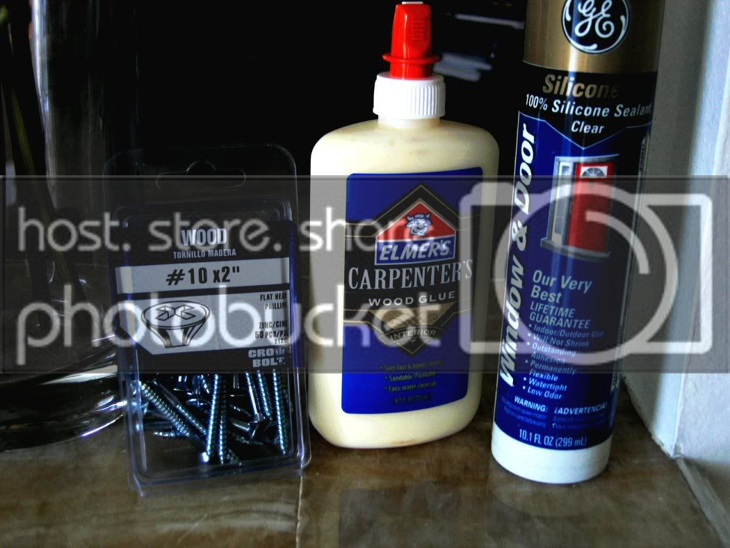

And some supplies - I hope I got the right screws. The Silicone is called "Silicone II".

i would have gotten drywall screws, they're cheaper and have the same purpose. also, i recommend against using cheap plywood like that as the wood isn't solid (not pressed well at all) and will resonate.
