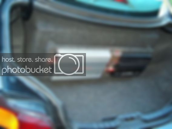

and this is how i want the amp rack to look, but i want it the same size as the box, so it wont be all cluttered.
