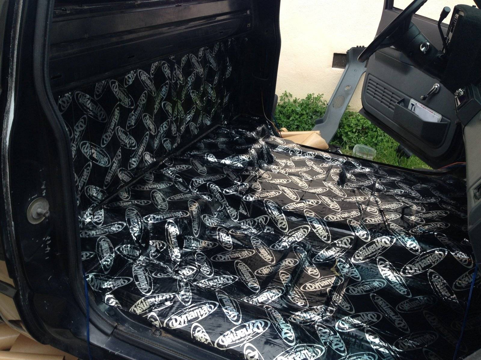

for my single cab 90 c1500 i bought the dynamat 36 sq ft bulk pack and it did this to the T.
With your truck I'd start with prolly 160 sq ft. Doors will need 12 sq ft. 1 layer each the floor and roof will take the most is double layer the roof tho and sides use the lighter weight deadener like the the stinger road kill. The heavier stuff tends to fall ofc after a while the efx deadener is pretty good as well
depends on how many layers...i would say to get the entire truck i would guess about 100sqft maybe 200sqft if you do double or triple thick on the floors and roof....just a guesstimate...
I would start with one or two packs of the Knu Kolossus. You don't have to cover everything 100%, anything after about 25-50% is diminishing returns although it will still reduce vibrations a little more.
