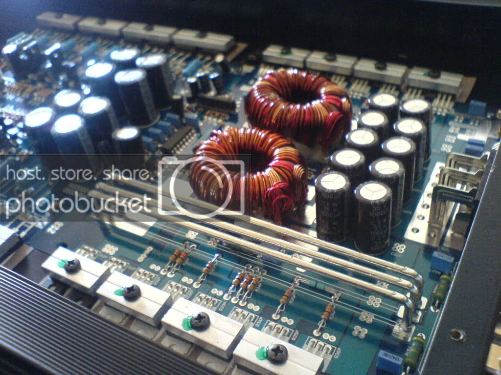

I have the Kenwood KAC-9105d which is rated at 900w @ 2ohm
I'm sure that is measured at 14.4v
My system stays at about 12.4v before I turn the bass on
Also I'm sure that amp doesn't have a perfect efficiency rating
I still haven't factored in impedence rise..
Any guesses on how many watts my amp is really doing?
KAC series is notoriously underpowered
I have never seen 1 do rated without issues... I would guesstimate maybe 800 rms
the newer models like yours are better than the prior series but not by much
with 3x 30A fuses it should theoretically be capable of 900 RMS at 14.4
Absolutely impossible to answer without knowing what frequency it's playing as it will put out a different amount of power at each frequency, unless of course you have it hooked up to a fixed resistor.
This is true, but he is just looking for an idea. Which why I said 650-750

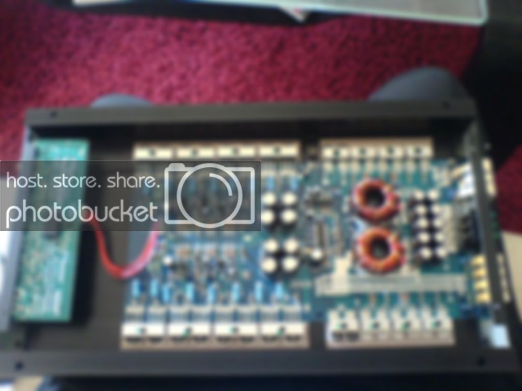

what do you guys think this will put out power wise? rated @ 720w 4ohm bridged 3x30A fuses
