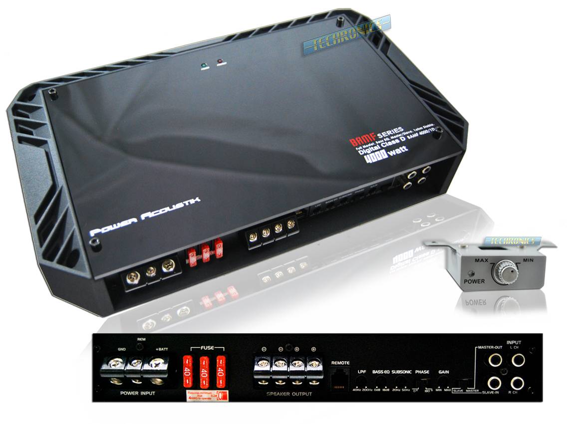

Im looking at a Power Acoustik 4000w amplifier, here are the specs
http://cgi.ebay.com/Power-Acoustik-BAMF4000-1D-New-Amplifier-4000-Watts-D_W0QQitemZ320351064540QQcmdZViewItemQQptZCar_Amplifiers?hash=item4a966951dc&_trksid=p3286.c0.m14&_trkparms=65:1|66:2|39:1|293:1|294:50#ht_987wt_1165
1200 Watts RMS @ 4 Ohms
1700 Watts RMS @ 2 Ohms
2200 Watts RMS @ 1 Ohm
4000 Watts Max Power
I know it says 2200 watts rms at 1 ohm....but how many watts do u think its really pushing?
Thanks
It's fused for ~1200:
10 watts per 1A of fusing is generally acceptable. It's not a science, but it will get you close.
