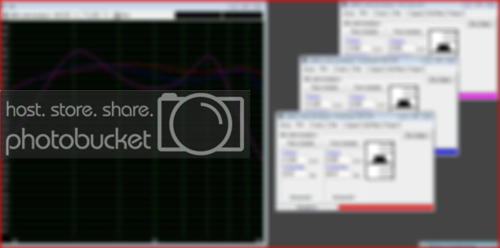

This is the graph for 4 18's that Fallen emailed me. Also this is NOT SPL oreiented setup.. Strictly a low end daily pounding wind machine. The blue line is the 18's, the orange is for AQ 15'sand the pink colored is AA Havoc 12's
Isn't that parallel tuned //content.invisioncic.com/y282845/emoticons/confused.gif.e820e0216602db4765798ac39d28caa9.gif
I have no clue man.//content.invisioncic.com/y282845/emoticons/confused.gif.e820e0216602db4765798ac39d28caa9.gif
Hmm weird... Guess I'll need to find out what program Fallen uses.. I myself though have found flaws in the WiniSD program. I think Fallen uses SoundEasy v.15
I'm no expert, his plots may be perfect.//content.invisioncic.com/y282845/emoticons/smile.gif.1ebc41e1811405b213edfc4622c41e27.gif
