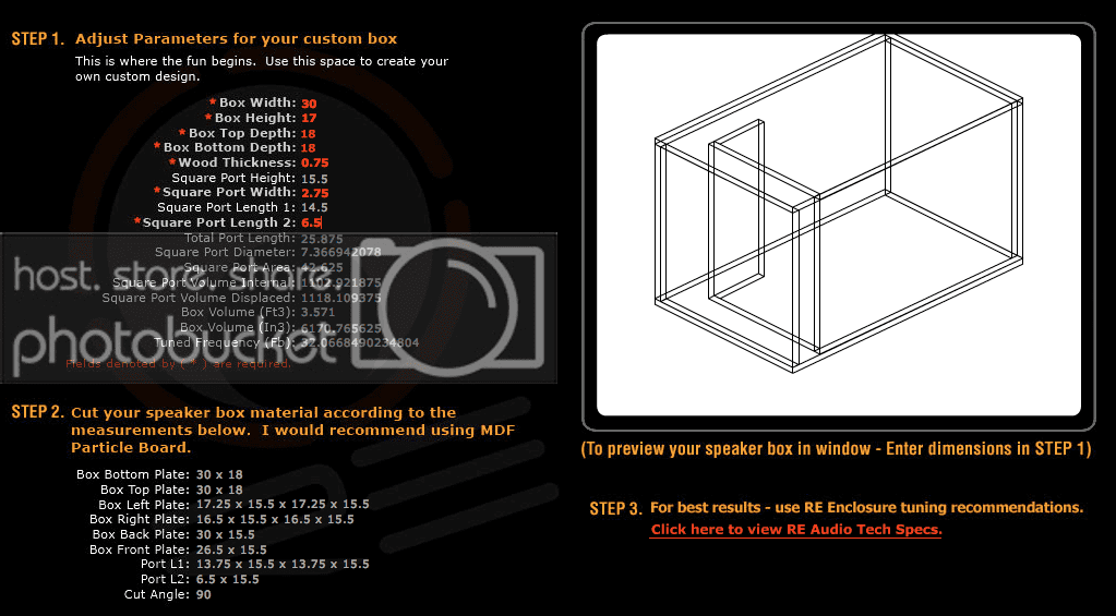

How does this enclosure look for a 15" CompVR?
Chase R
I'm getting ready to build a box for a 15" CompVR and I just wanted to run the design by you guys. The port specs are straight from Kicker's site. What do you guys think?
If it helps any... It's going in an E39 BMW. I listen to a lot of trance and rap.
Thanks! Awesome forum BTW!
I changed up the design just a bit. I made it a little wider and shorter in depth to better fit the car. I also had a question about port width... Would 3" be better or should I stick with 2.75"?
