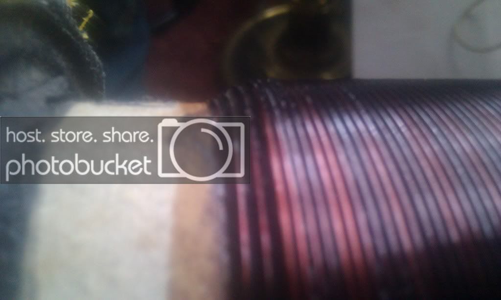

i am just trying to understand how is it that you can have pos and neg touching each other without sparks or anything??? every time i touch pos to neg i get sparks shouldn't this be the same concept?
That red/brown on the wire is a shellac/epoxy that keeps the wire from shorting. If you get a high enough voltage on the coil you will exceed the capacitence of the enamel and it will arc right through it and burn a hole in the coil....prett extreme, but it is possible.
hmm so this would be like when the coil heats up too much and burns that shellac off that is when i coils unravel and the subwoofer "blows?"
The glue that holds the coil together is different. The wire comes with the shallac on it (you can buy it online...when you're in science class in school and make an electro-magnet with a nail that's what you use.... also the same wire they sell to wrap transformers with, or in your alternator, or other electric motors....same principal anyway)
When it goes slinky that's the glue that holds the coil together on the former melting. You can just straight out melt the wire of the coil, and if you have a misaligned coil or get a piece of debris in the gap that wears the coating off the coil it will also arc and burn a hole in it.
There's a few different ways a coil can fail from heat/abuse. I've tried quite a few myself //content.invisioncic.com/y282845/emoticons/biggrin.gif.d71a5d36fcbab170f2364c9f2e3946cb.gif
