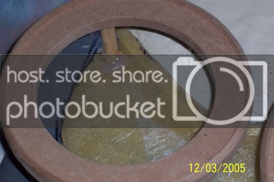

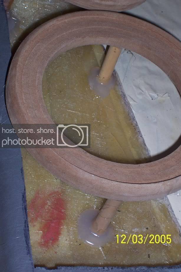

I use a router table and a round over bit . But you can do it with out a table . Use a straight bit to cut your outside dimater circle first . Then Just round over the outside before you cut out the center . It will give you a more stable surface . Roundover bits have guide bearings on them allready:)
Chamfering is the same except you use a chamfering bit and have to do it after you cut out the center obviously //content.invisioncic.com/y282845/emoticons/smile.gif.1ebc41e1811405b213edfc4622c41e27.gif
That what your after with the round over ? //content.invisioncic.com/y282845/emoticons/smile.gif.1ebc41e1811405b213edfc4622c41e27.gif
