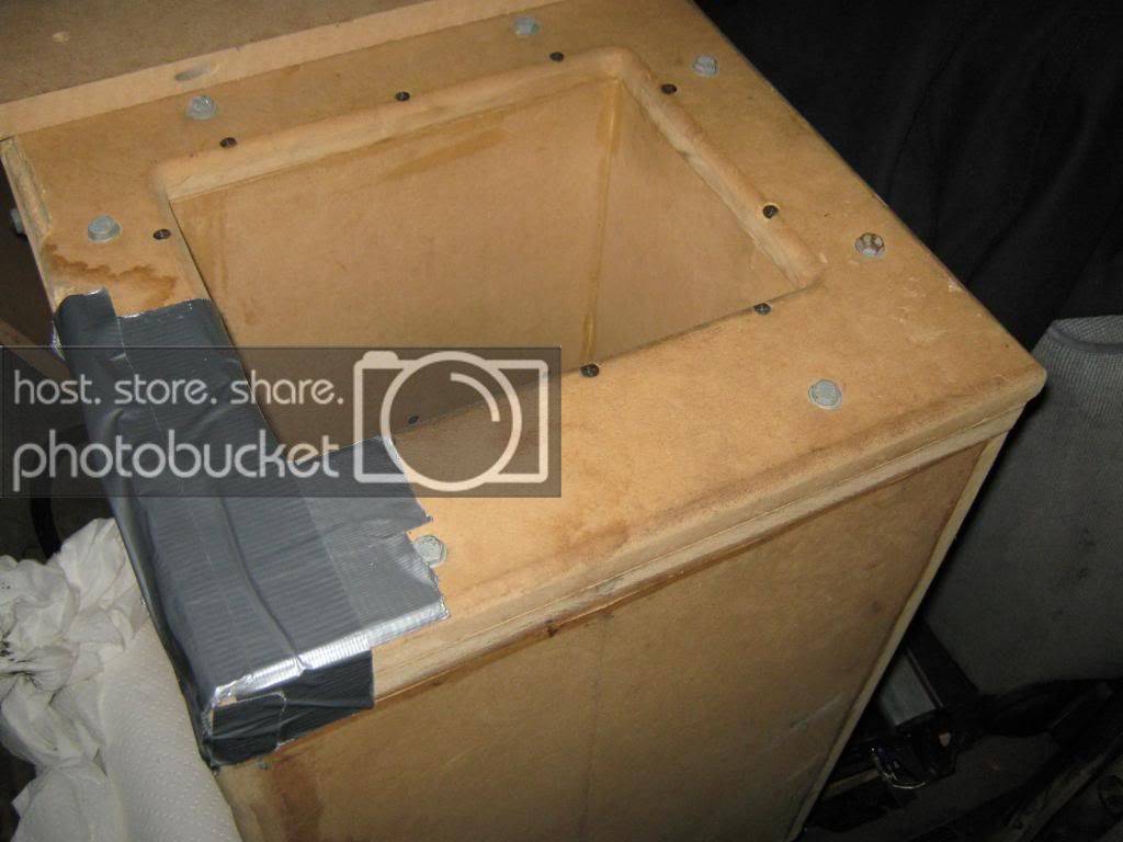

square port i made out of birch attached that was 8x8, i made one for daily and one for comps.

youll have to ignore the extra sheet of wood i got there one of my 10s is out of commission so i grabbed the first peice of mdf i had and covered it up... then the duct tape is for decoration //content.invisioncic.com/y282845/emoticons/wink.gif.608e3ea05f1a9f98611af0861652f8fb.gif had a little water leak lol

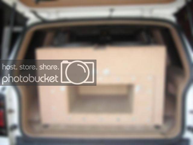

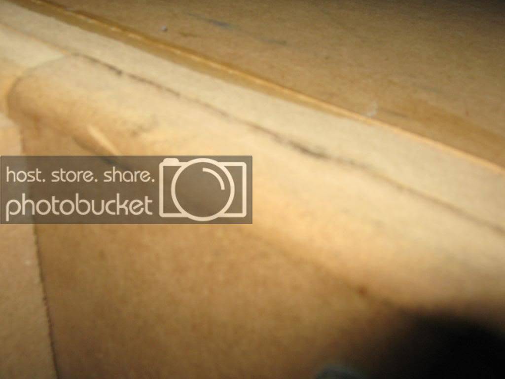

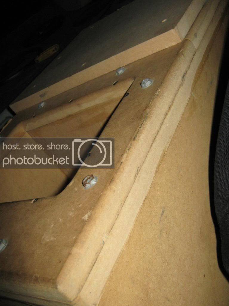

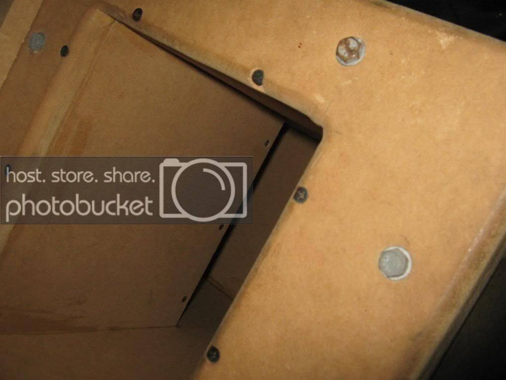

not guna take it out right now unless you really have to see it... but the bolts you see come out and the port slides out i have my 50hz port at the other house the one in there right now is 35hz box is double baffled you can see where the baffle ends and the port begins...
btw if he is still running around here i didnt make this box so ill give credit where its due.... Cannon White built it and it is one of the best boxes ive used...//content.invisioncic.com/y282845/emoticons/toast.gif.bc0657bf54b9ee653b6438524461341e.gif
figured i might as well show the rest of it too //content.invisioncic.com/y282845/emoticons/wink.gif.608e3ea05f1a9f98611af0861652f8fb.gif
box is 6.5 cubes with 2 3/4" steel braces and fiberglass resin on the inside made for 3 10s for a truck but i got a good deal on the subs and the box came with so... previous owner is a good friend of mine
