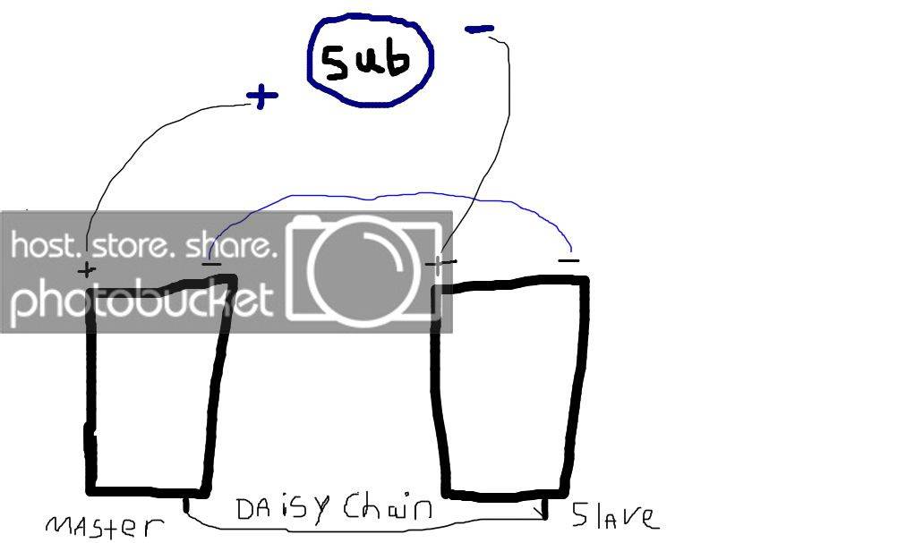

I will be running a pair of aq 1200d's on a hdc3 12, d1. How do I go about strapping the amps?
You take the negatives on the both amps and connect them with speaker wire.
Then you take your positive on one amp to the negative on the speaker, and take the other positive on the other amp and put that to the positive on the speaker.
Like this, sorry for bad drawing, hard to do on computer.
