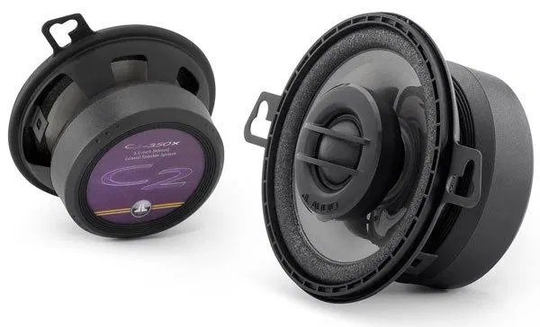

You could do a 6x9 midbass in the doors and something like these in the dash...
