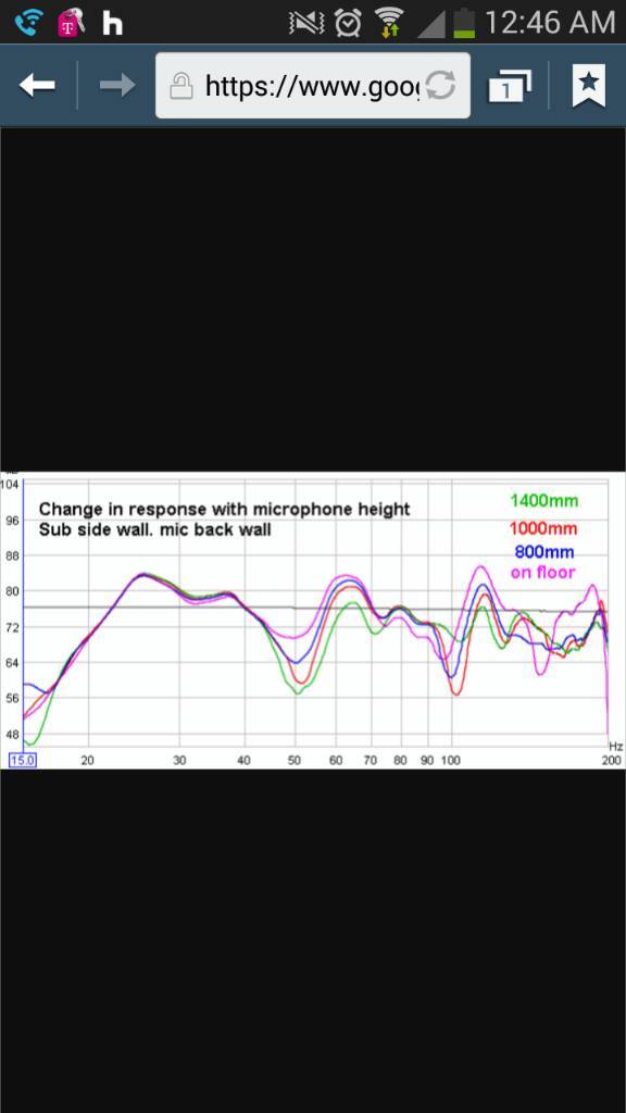

The Camry Hey, I Try. 3,001 3 Western Oregon May 29, 2016 #2 suppose my box is port, how I know the hz? Click to expand... Get a mic. Download REW (room eq). Do a frequency sweep. Look for the highest peak. That box is ported at 25hz. See how it peaks and then gets quieter?
