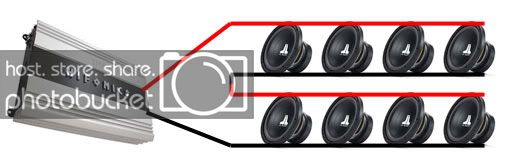

How can i put 8 subwoofers in my van?
you could wire up all in parallel to drop to a 0.5ohm loadyou can find some amps to handle that for relatively cheap (lanzar opti2000) ~$300
unless i missed something it would be a 1 ohm, or a .25 ohm
you wire each speaker the same, then connect them all together
each speaker gets a jumper from one POS coil to the other NEG coil, makes 8 8 ohm loads.
then just go POS/NEG on each sub
then you have 2 wires going out to the amp....
I don't see one for 8 subs.

Yeh. Only options are 1ohm or .25, I have exact setup in my truck now.
8 10s and 1 amp

For all this crap your trying to do you could get 4 12"s or 4 15"s and simplify your wiring, amp selection, box design, box cost, box building time, Wiring cost and overall hassle that 8 subs would cost you over just doing 4.
