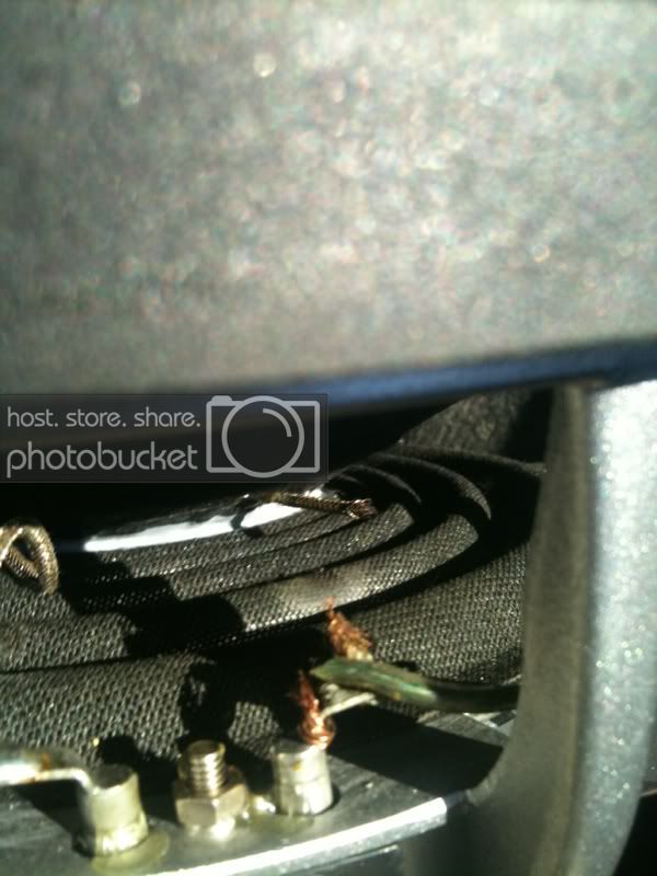

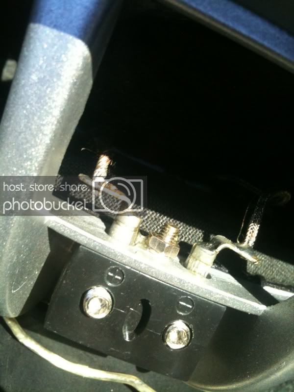

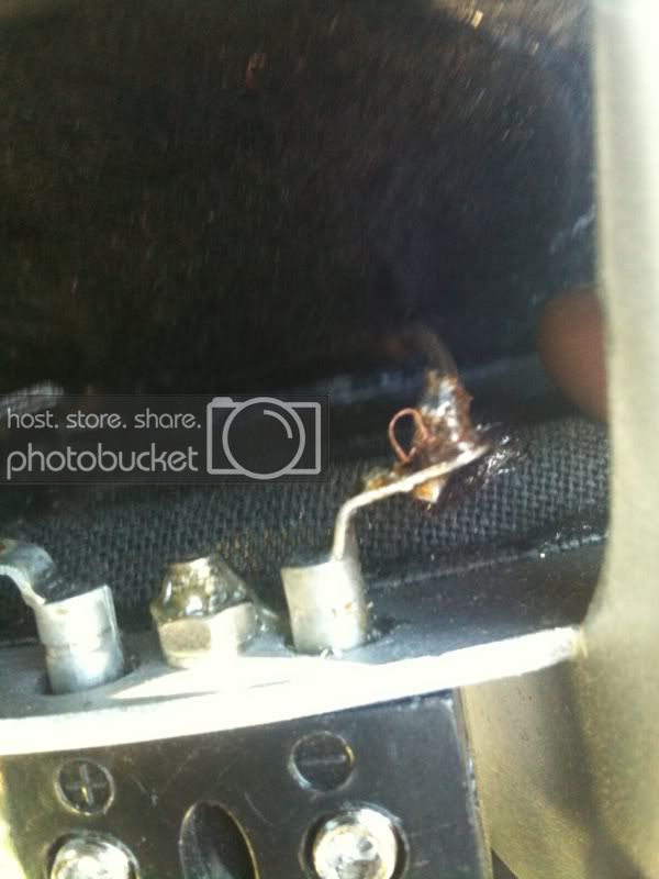

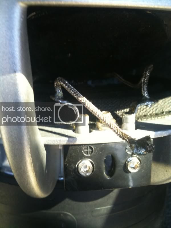

F fatt_macc_2k4 10+ year member Box Chevy Ryda 220 0 oklahoma city,ok Oct 6, 2010 #1 pics are pretty self explanatory these are re se 12's btw Click to read more...
heyitsmekyle15 10+ year member Member 113 1 lincoln, NE Oct 6, 2010 #2 re-solder the leads back together if at all possible. If not recone it. What driver is that anyways? re sx?
Ronny 10+ year member CarAudio.com Elite 734 13 Grand Forks, ND Oct 6, 2010 #3 Resolder. Unless one of those leads is broken off right at the cone? Take dustcap off, and run new leads and solder them onto the coil exposed underneath the dustcap and reglue it on.
OP F fatt_macc_2k4 10+ year member Box Chevy Ryda 220 0 oklahoma city,ok Oct 6, 2010 Thread Starter #4 Thanks
S SPLaudio 5,000+ posts CarAudio.com Veteran 6,745 60 upstate ny Oct 6, 2010 #5 needs all new leads. re audio never put long enough lead wires on...
