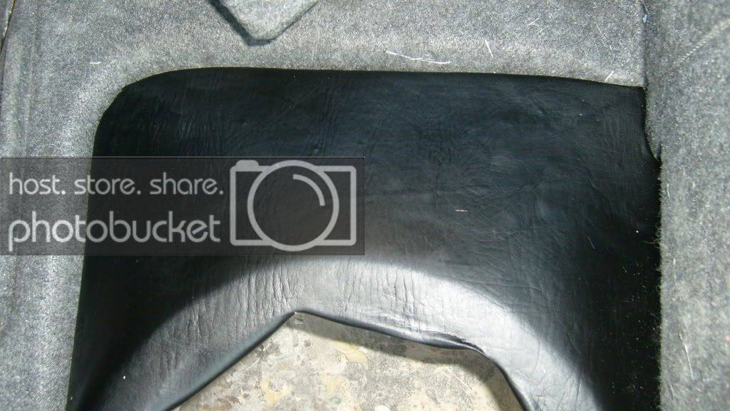

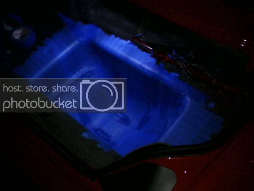

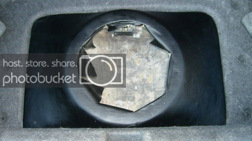

I just finished another subwoofer box, this time for an S2000 that wanted to use a JL W6v2. Not having alot of space to work with I managed to make a box that was 1.5 ft^3 that looked great.
Masking off the trunk

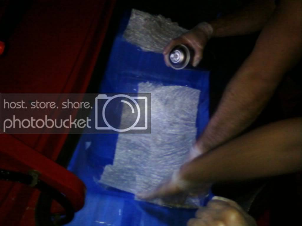

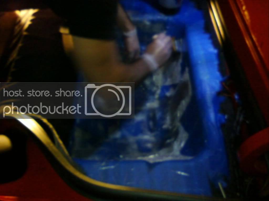

Laying first layers of fiberglass mat

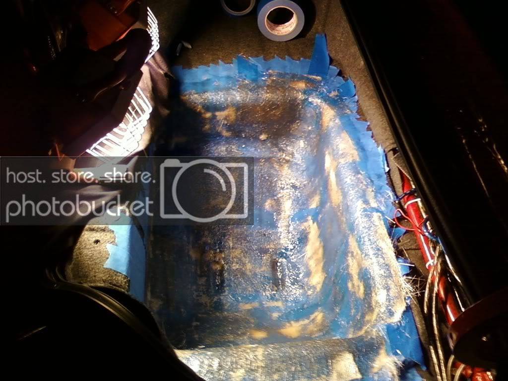

First layers complete

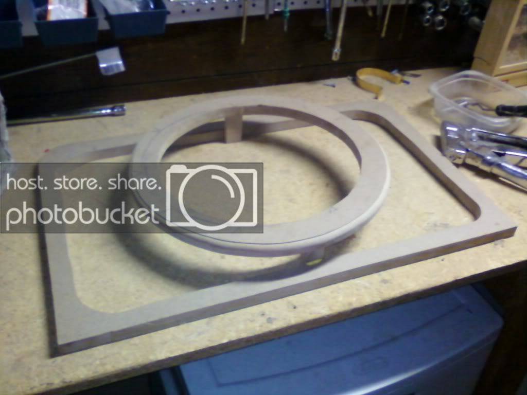

Template for the subwoofer

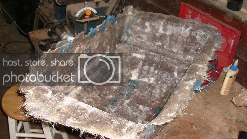

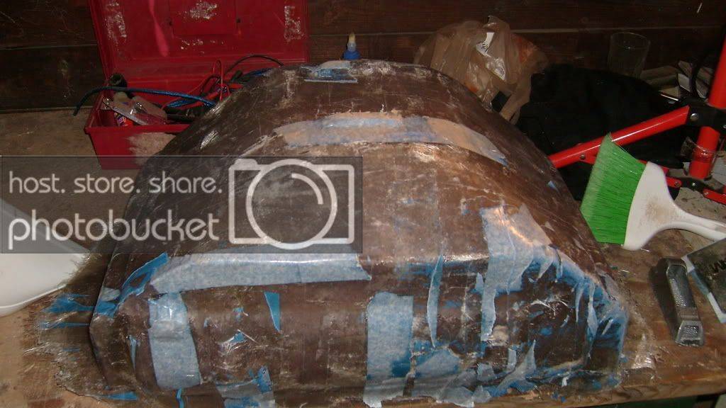

Fiberglass mold complete
Completed box in car
Well, actually there will be a top piece that will be Carbon fiber that will hold the amps, so as far as "blending".... it will. Patience my dear //content.invisioncic.com/y282845/emoticons/smile.gif.1ebc41e1811405b213edfc4622c41e27.gif
Not bad sir, not bad at all . But I see some dry spots in the mat. Need better saturation //content.invisioncic.com/y282845/emoticons/smile.gif.1ebc41e1811405b213edfc4622c41e27.gif
