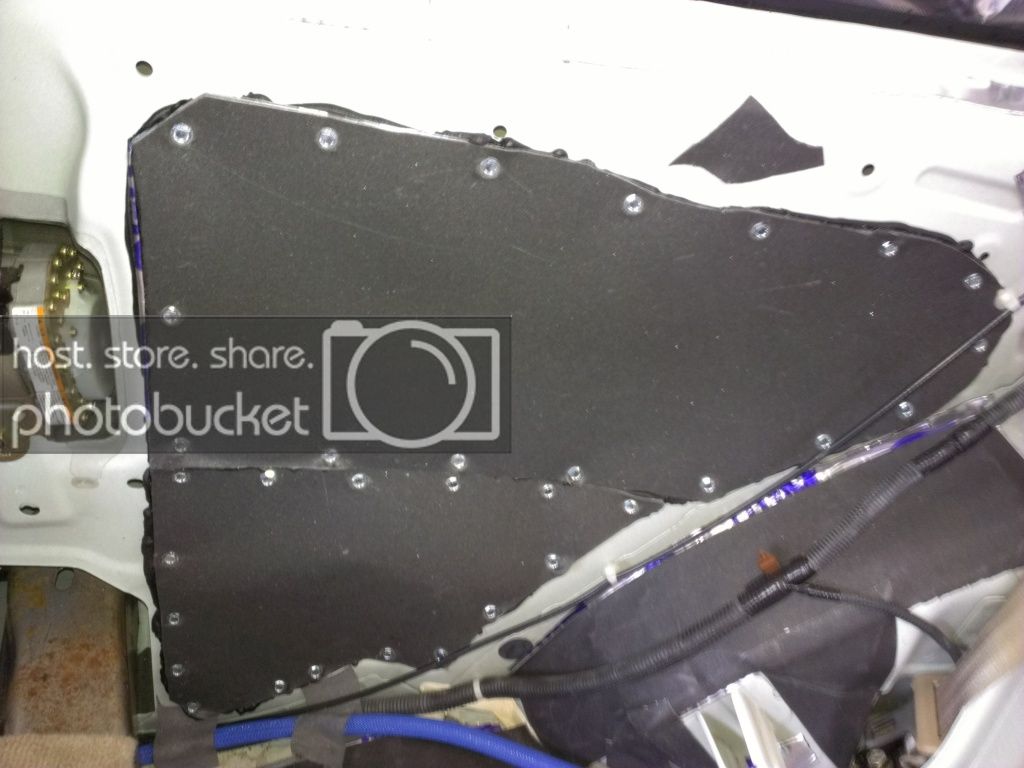

Forgot to post this, covered the rear side panels that had the huge holes, noticeable difference in noise, but not much for the effort, still worth it. covered with rammat on the inside and a mass loaded vinyl type sheet on the outside.

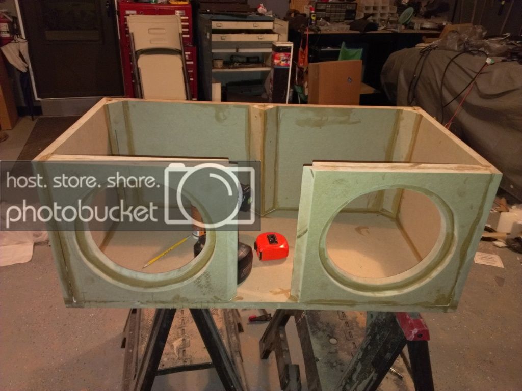

Well the box is started and taking forever to do, im starting to freak out i have 2 days left before i leave for college well actually i leave thurs night....
