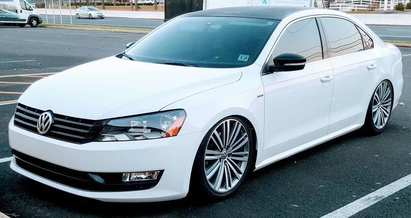

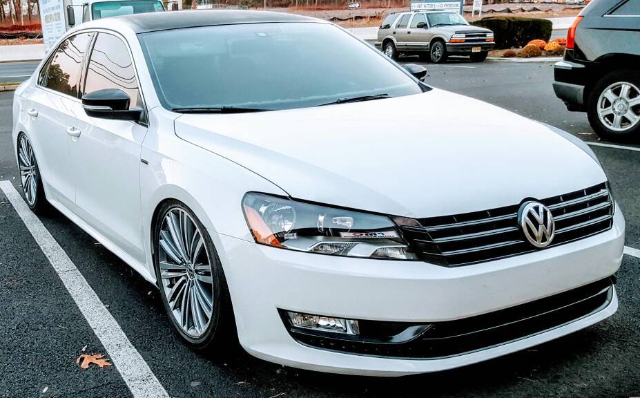

As long as i have a sound quality higher than stock, i am happy. I just put air suspension in my car that cost me an arm & leg. But that's something i enjoy! Pics below
