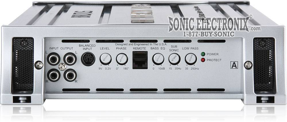

I purchased a new hifonics BXI1210D from vminovations to connect to my set of pioneer ts308D4 at 1 ohm in a dual ported box, should i be alright? any tips in makin my install better?
Any good ideas on setting the gain or any other settings?

-level 1/2 up, LPF 1/2 up, SUBsonic filter 1/4 up

as far as the settings, the gain should be set according to the output voltage of your head unit. the LPF should be set to match any HPF on your speakers. The Subsonic filter should be set just below the tuning frequency of your ported box.

today i connected everything up, current my amp settings are
level = between 11 and 12 o'clock position
subsonic filter = 10 o'clock position
LPF = 12 o'clock position
bassboost = default position
every other setting that i didnt mention is at default
I had to turn the gain/level up to the 12 o'clock position which is half way up, so that i can actually feel the bass, is that right? my HU volume maxes at 35, so i turn it up to 28-29 should that be alright? i dont want to over stress my amp

also i read other forums and found out that my HU is 2 volts at the sub pre-out, is that why i have to turn up the gain to like 12" o clock, i think i should put it to 1 o'clock
my last question, sorry if im being such a noob, i have a bass knob that connects to my amp, i know its like a gain knob or maybe a bass boost knob, not to sure but whats the correct way to use it?

look in the manual to determine if the knob is a bass boost at a certain frequency, or just level control (i.e. attenuation). if it's a bass boost, be careful. if it's level control, use it however you want.
thats good to know, so just to make sure im on the safe side, should my gain level be good at 12' o clock to 1' o clock posititon? my amp doesnt seem to clip and warm up either
If the level dial on the amp is labeled accurately at all then you'd have 4-4.5v at 12 o'clock. It SEEMS like you'd be safe in the 1-2 o'clock range given the 2v HU pre-amps.
If you bring your LPF down a bit (10-11 instead of 12) you might clean up some top end sloppyness of the subs. Mine always seem to sound the best crossed over closer to 80.
In general I think you're in good shape. What's left to adjust would just be up to your personal preference.
