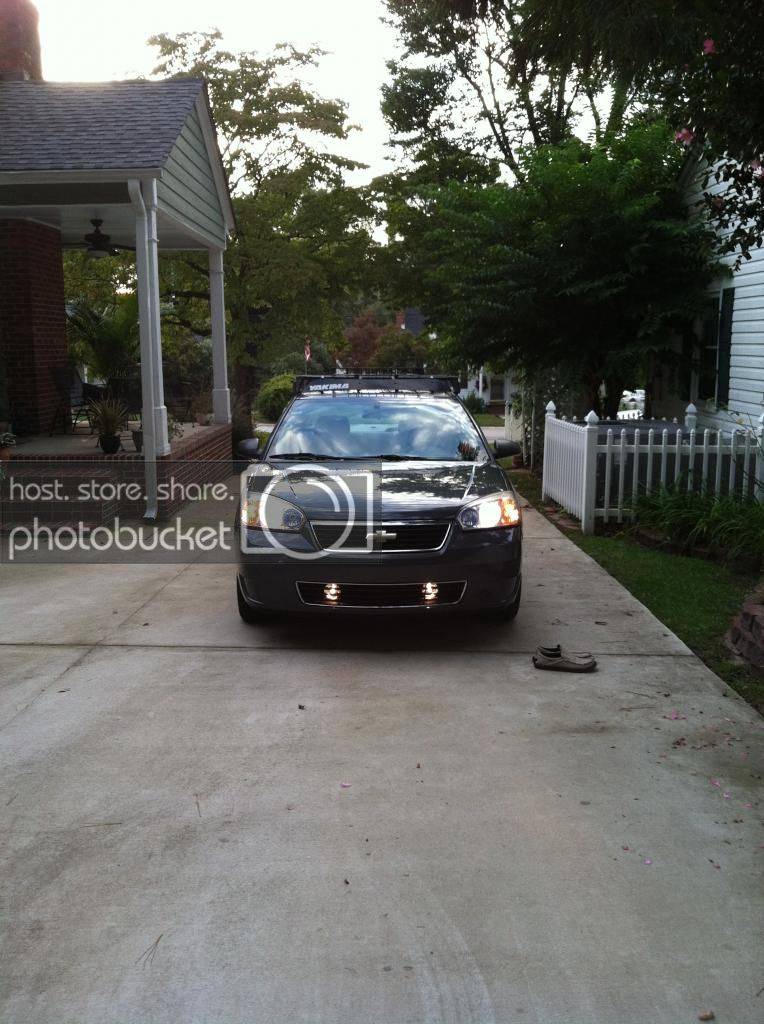

just bought me a hid kit helios 8k, just wondering what if anything else should i do to my headlights, the bulb beside the headlight im guessing is the highbeam(lol) should i get a new bulb for that aswell to match? i was thinking fog lights in the grill too, i seen this and liked it

You need another HID kit to do the high beams. Depending on how it performs with the low beam kit you might want to leave them alone. I drive on dark 2-lane roads and I only have my low beams upgraded with a 5K HID kit by RaceSport.
HIDs in most reflector style headlights, like yours, will most likely create a terrible glare and a hazard for oncoming drivers.
Projector headlights are the ones that are usually more accepting of HIDs.

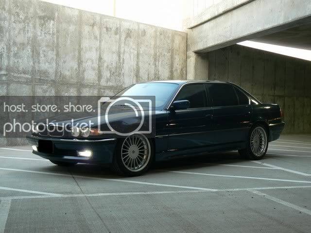

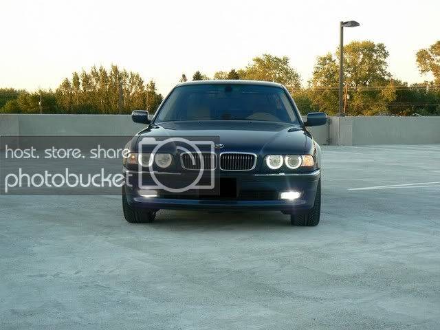

Here is my x with Upgraded 12W 6000K LED Angel Eye's and Matching 6000K HID fogs. My lows are 6000K as well.
