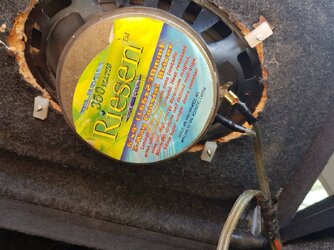

the 6"x9" speakers are some old ones and all info i have about them is this:
57284409_467497813791072_7839784511842811904_n.jpg also i mesured 4 ohm on them.

but will what i linked work fine together, as long as i use the right wires and fuses or is there any better combinations? i have all the components linked in the post already, im just missing the amplifier.
The pio amp would be great, even ideal.
It is much more powerful than the 4's need, keep the gain low and the high pass filter pretty high.
There's no series/parallel issues.  It's a 4 channel amp with 4 speakers -- a speaker on each channel.
