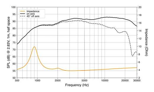

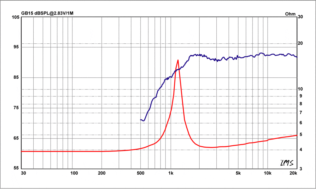

Hi Mr Green,
I don't see AudioFrog stays 97db +/-1. It should be around 92~3db. Please see the graph below from AudioFrog website.
AudioFrog GB15:
Hertz Mille Legend 280.3
