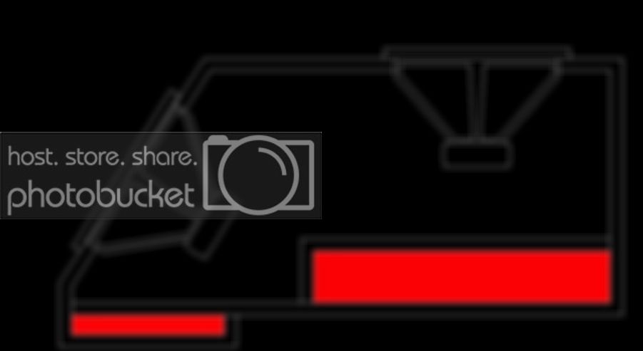

Well im going at building another box for my truck, its going to be sealed this time. I have 2 jl W0's I did the math out for one in a sealed box. It calls for like 2.3 Ft^3. In the JL manual they say to use 1.5^3. I rather stick with the 1.5 but what do you guys think is better?
So heres my box design. Sorry if im being a pain I just dont want to **** it up this time. The red area is dead space. I need the outside dimensions of the box to be the size they are. So to remove airspace i decided to just build out cubes. Its 3Ft^3.
I noticed a big improvement from firing my 2 boston acoustic 12's upward (in sealed boxes) to 1 firing downward (sealed box). Eventually I will add the second, but it sounds only a little less loud but MUCH better firing down in the cab. I dunno how much room you have, but from the looks of your box you could raise the floor and add both subs firing down. Something to think about anyway!
