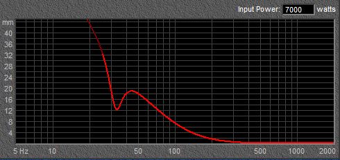

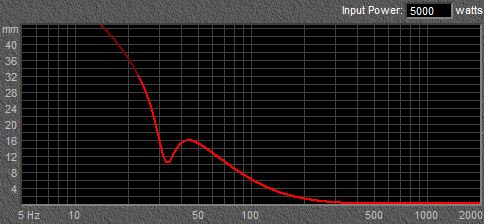

Is that program pretty acruate or just a good thing to go by?  Another cool guy hooked me up and plotted them for me on another site, heres what he got.
.  Due note my sub is 33m not 32mm but doubt that makes much dif.   BUT at 33mm on the graph it does kinda show like 24-25hz would be fine at 7000 watts,  So a 25hz subsonic with a 12db octave should have enough of a roll off at 25hz i should be fine?
He also said this
""From the plots you can see that at 5K input you would reach the 32mm at say 23 Hz BUT at 7K you would reach Xmax at about 26Hz so the 25Hz subsinic filter is a better fit for 5K power if you want to keep in the linear region.""
He also said this

You do have enough power there to break that sub if you're not careful.  Really hard telling if it'll ever have mechanical trouble though.  I tune a fair bit higher and don't run subsonic but I don't try to listen to whale songs or slowed music or anything that would push them.   If you only listen to normal music you very likely won't be trying to play mid 20hz and down and won't need to worry there, if you like to play slowed stuff or test tones you might consider tuning your box lower to keep it under control and allow you output.  25hz subsonic will definitely still be attenuating around your tuning frequency, test it out either way without going balls out and compare for yourself.   It should be about impossible for you to break that sub mechanically with the subsonic on but it may well rob you of output you want.
