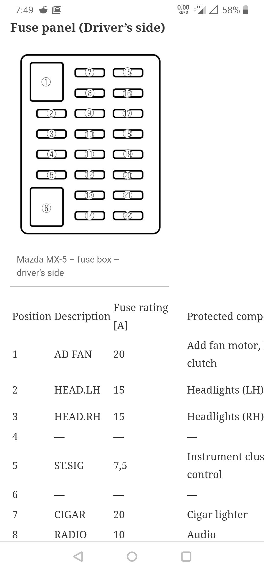

Did you check #8 in the fuse box on drivers side?

I appreciate everyone's time and attention! The problem turned out to be two fuses. One under the hood, and one under the dash. Again, thanks for putting on the right path, beyond my own pissed offed ness!
