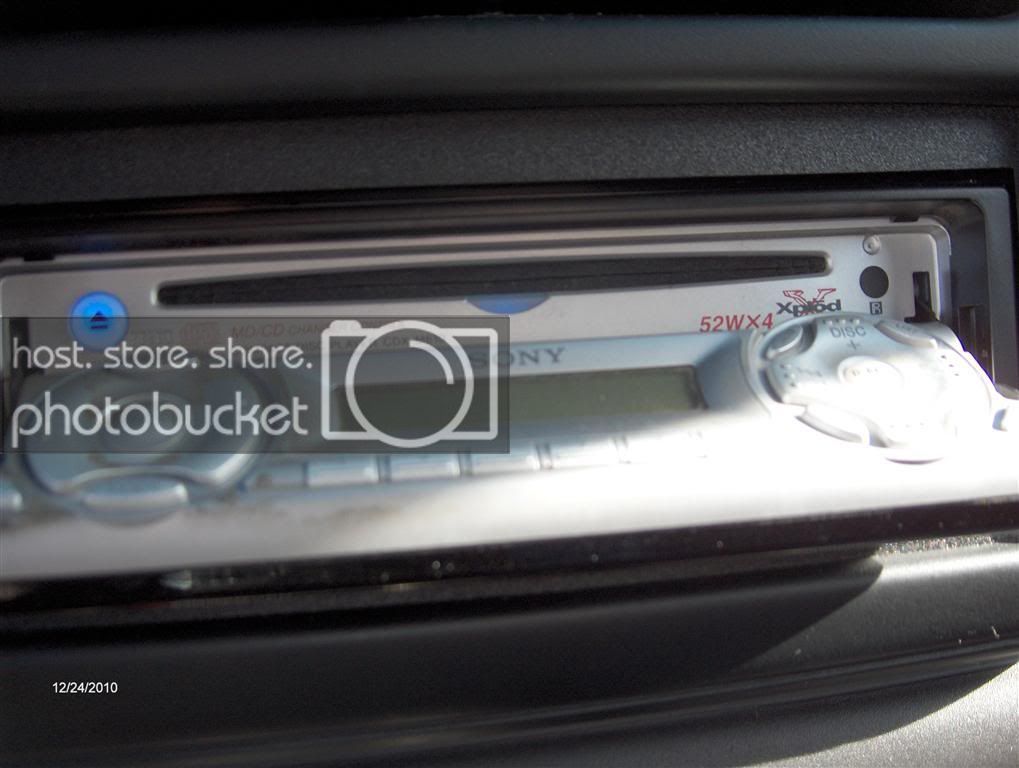

I have an older Sony CDX-M610 head unit that stopped working recently, man has it been annoying to drive around listening to air //content.invisioncic.com/y282845/emoticons/waycrazy.gif.f4a380c3f94043939fd369defd9e6be2.gif lol.
Anyway, the weird thing is the top half still lights up and works, it's the bottom half that's dead. Here's a pic
I tried changing the radio fuse and the fuse at the back of the heat unit to no avail, any advice?

Also I bet I know whats wrong with that deck.
There is a ribbon cable that goes from the face to inide the unit, These would break over the years you can get them on ebay for about 20.00 bucks shipped and about a hour of your time.
I have replaced several of these on the M600 units.
