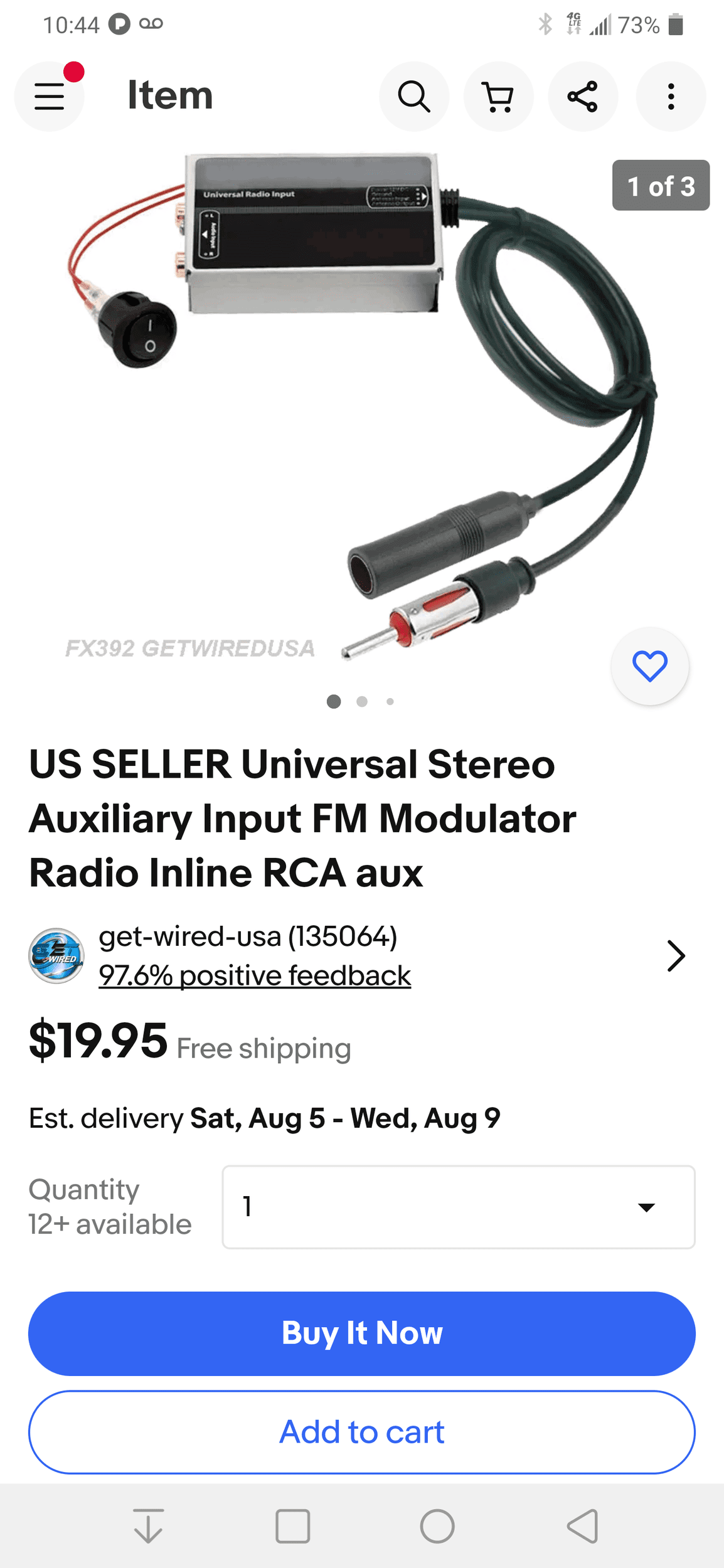

All new non-OEM radios have RCA outputs that will connect direct to your amp. Right now you may be using an LOC, that will be removed.
You can add an FM modulator to your current radio for BT playback.
