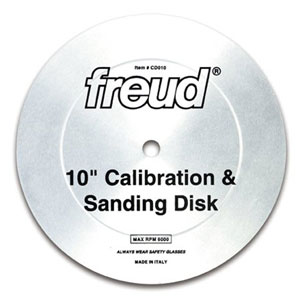

OP, you might pick up a calibration disc and use a dial indicator or nice square to check how true everything is. Get the saw and table perfectly lined up with each other and then take a look at the fence. There should be adjustments you can make on the fence to bring it in true while it is clamped to the guide. Once you do all of that, you will be able to determine if there is real problem with repeatability of the fence clamp mechanism.
