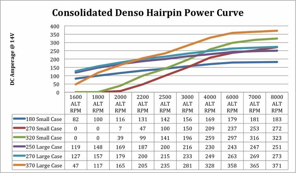

Hello I was recently quoted for a high out put alt for my 2006 dodge stratus, the makers of the alt which I'll keep out claims that after I go with a larger than 200amp alt I will no longer get idle amp but will get more amps at about the 2500 rpm range and higher. Is this common in small hairpin alts? Another thing is my normal commute is only 2 miles long and top speed of 30 mph, in which case my max rpm is only about 2000, will I end up killing my battery from not being charged while I listen to music?
I've talked to them and they quoted me the same price fornthebsame alt. And claimed the same thing. Seems like like screwed either way huh? No alt and I have flickering lights, bigger alt and I'll have to on extra drives everyday to charge my battery, hmm.
This is what I was told. "Small Case Hairpin Line
- 140A HOT "160A", 90A HOT @ idle, 110A COLD @ idle, 120A HOT @ 2500 Alternator RPM - $325
- 160A HOT "180A", 110A HOT @ idle, 125A COLD @ idle, 140A HOT @ 2500 Alternator RPM - $350
- 200A HOT "210A", 100A HOT @ idle, 130A COLD @ idle, 120A HOT @ 2500 Alternator RPM - $450
- 240A HOT "250A", 55A HOT @ idle, 70A COLD @ idle, 140A HOT @ 2500 Alternator RPM - $499
- 270A HOT "280A", 0A HOT @ idle, 0A COLD @ idle, 100A HOT @ 2500 Alternator RPM - $599
- 320A HOT "330A", 0A HOT @ idle, 0A COLD @ idle, 140A HOT @ 2500 Alternator RPM - $649"

High-output alternators in small cases have limited output at low RPM. My 320 amp small-case puts out next to nothing at idle, lol.

Unfortunately, that is the truth - especially with small case hairpins. I'd hope any reputable company would agree. Please see the chart below. Small case hairpins significantly lack in low-end output. Large case high amperage (370s, 390s, etc) also share similar characteristics, just not as bad. Large case 240s, 250s, 270s will have the best idle output. Please keep in mind that alt rpm is roughly 3x engine rpm (1800 alt rpm = 600 engine rpm)
