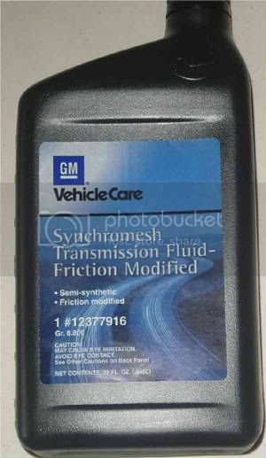

Alright well I missed your suggestion casper97ta. Today though I changed my filter and put in GM Sycnhromesh that was friction modified. I read about it online and people said it was the best stuff out there.
Today I went to the dealership because it is the only place to get it. 13 dollars a quart I was hoping it would do the job.
I put it in this morning and just drove smooth and slowly to let the new fluid flow and broke it in for about 50 miles. After I let it all flow through I tested it out and no more grinds!!//content.invisioncic.com/y282845/emoticons/smile.gif.1ebc41e1811405b213edfc4622c41e27.gif
If anyone has a small little grind I'd try this stuff. It's semi synthetic and worth the money.
