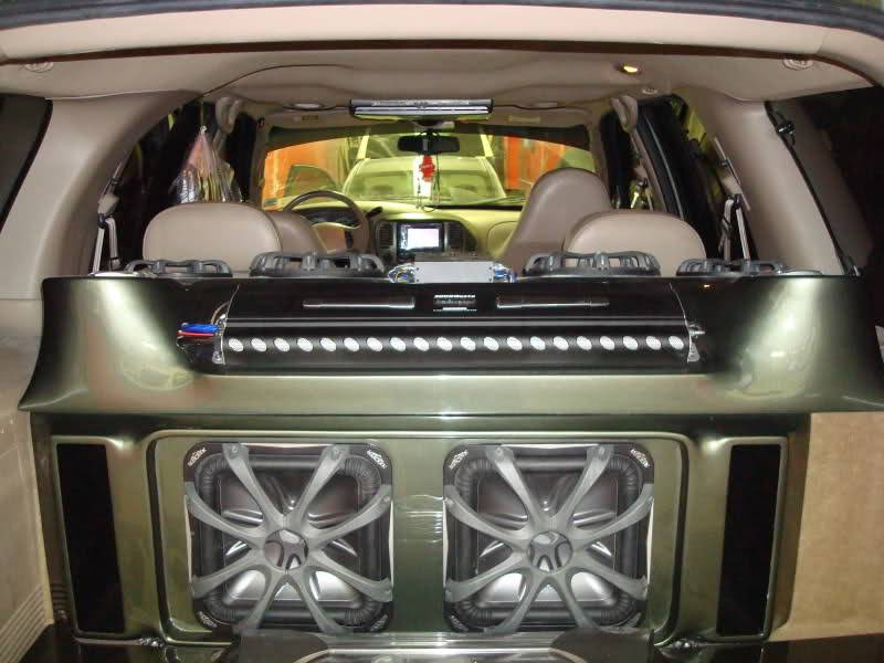

2 L7 12's in 4 cubes with 2 40square inch ports tuned to 36hz
audiopipe 3kd

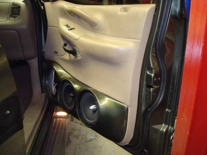

I'm feeling those doors, there should be plenty of punch and output up front.
The install looks good so far.//content.invisioncic.com/y282845/emoticons/cool.gif.3bcaf8f141236c00f8044d07150e34f7.gif
