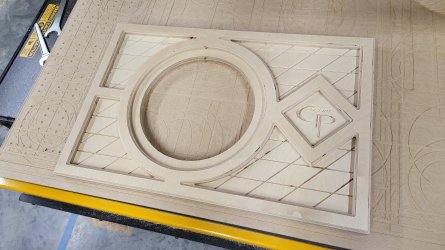

Let me start off by saying this dude Tyler was very thorough. He was super nice and open to any questions or ideas I had for the box. I went with the Elite High Output XL enclosure with them, double baffles, extra bracing, all the bells and whistles. Tyler told me everything he had designed for the enclosure, he was very familiar with SSA's subs and was excited to build a custom box for a Zcon 15. He spent several hours in design on it he said, he said he had a sweet double baffle layout done and exact specs I gathered from SSA themselves and others who were mentioned to me on the board here. This thing should absolutely pound but stay accurate as hell as we went with 15.25" of port area per square foot instead of 16". He said it was going to sound and look awesome. I went with some custom etched designs that were part of the deal and he had no problem adding anything included. Really good experience so far, thanks to Audiobahn for the shout out. Edit: Awe crap just noticed I biffed the title with a typo LOL!

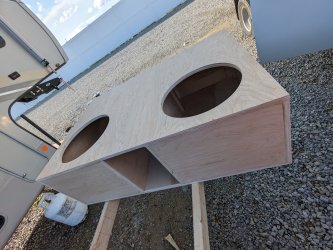

Here is a sneak peak of the top Baffle

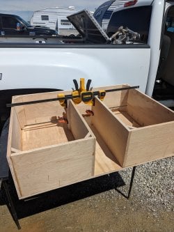

So far I'm really happy, I did spend a little money on this but it's birch. The big thing is he design's the box, he doesn't just cut up some wood. They look at your speaker parameters and make sure everything is copasetic. Just to buy an authentic piece of 4x8 .75" Birch around here is $180 so I do not feel that bad honestly. And plus I could never achieve these cuts or design with the tools I own. I would have to go buy $400 in tools, and I'm not going to build a ton of boxes, just don't have the time with my work schedule. It was worth it to me.
Doesn’t look like they do 45s in the corners
To be completely honest I hate doing 45s for the corners. I don't think you gain that much strength and they are a royal pain to cut with a circular saw.
Table saw isn't bad but I hate doing it with a straight edge and a circular saw. I just did a 2 skar vxf 15 box with them and I hate attaching them
