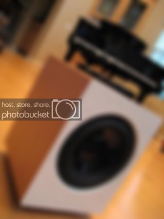

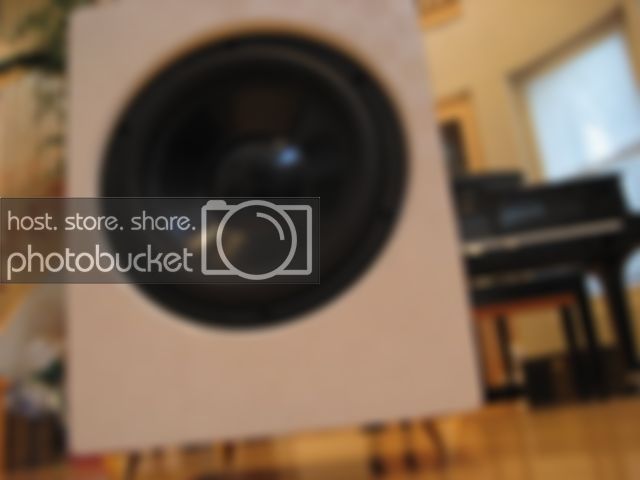

Built one for a friends studio,
Sucker is loud on 350 plate amp , very musical, its .8 @ 25hz
Liked it more than my e10.44 sealed
