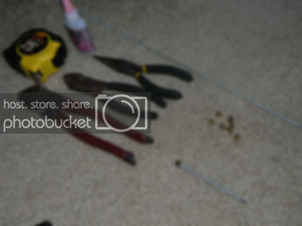

here's a pic of the tools used to make my bolts.....a 3ft rod size 6/32ths, acorn and regular nuts, heavy duty cutter to cut the rod, plyers to help manipulate the parts, and ca glue....
